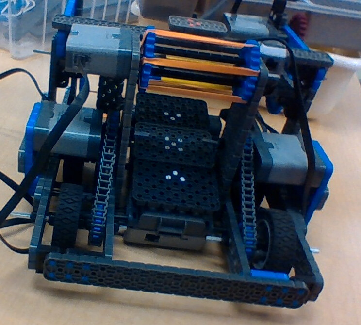

When i drive my robot that is not even that heavy it drives very choppy and it goes fast for about 1 second then it goes to slow and then it goes to fast again. I know it is not anything to do with the code and i also changed out the motors. It it because of the chains, because this is also my first time using chains on a robot.

Ok here is the picture
Sorry that the picture is dark and not that clear i took it using a chromebook.

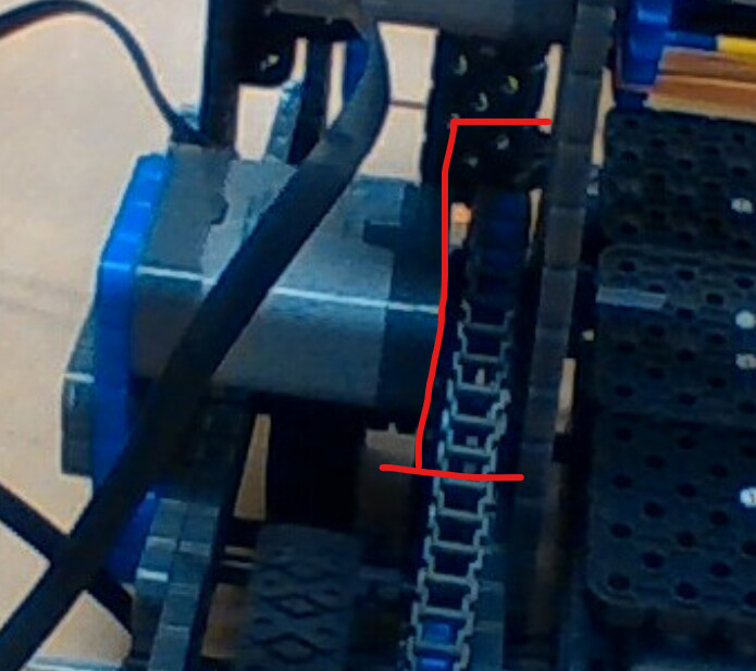

Yeah, I’d recommend adding a link to the chain on either side. You can tension it with standoffs if needed, too. The sprockets for the drive don’t look completely aligned either, which could definitely add some more friction. The drive motors also need to be supported closer to the shaft, supporting them from the back like that won’t be enough. They look like they are bending down right now, which would definitely add more friction to the shaft.

The motor on the top rubber band roller seems to be bending outwards, or the plate it’s on is bending under the stress. I’d recommend bracing it to the other side.
Ok, so ill add 1 link to the chain and then i build bottom support kinda shaped like a U to hold the motor in place because the back support is not enough? You said something about moving the motor forward but i cant because the chain wouldn’t be straight. What should i do to move the motor closer while still having a straight chain? What do you mean by bracing it to the other side do i just connect them together or do i lower the with of the gear so it doesn’t bend the plastic?
You can use a beam and some standoffs/angle connectors to make a box to mount the motor on, like this:

Yeah. If the upper motors are turning… causing the plate distance to vary, that would affect friction in the bottom motor shafts.
I would check shafts… make sure they are all straight. Your problem sounds like friction.
