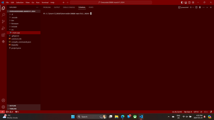

Why is my Visual studio terminal not uploading code?

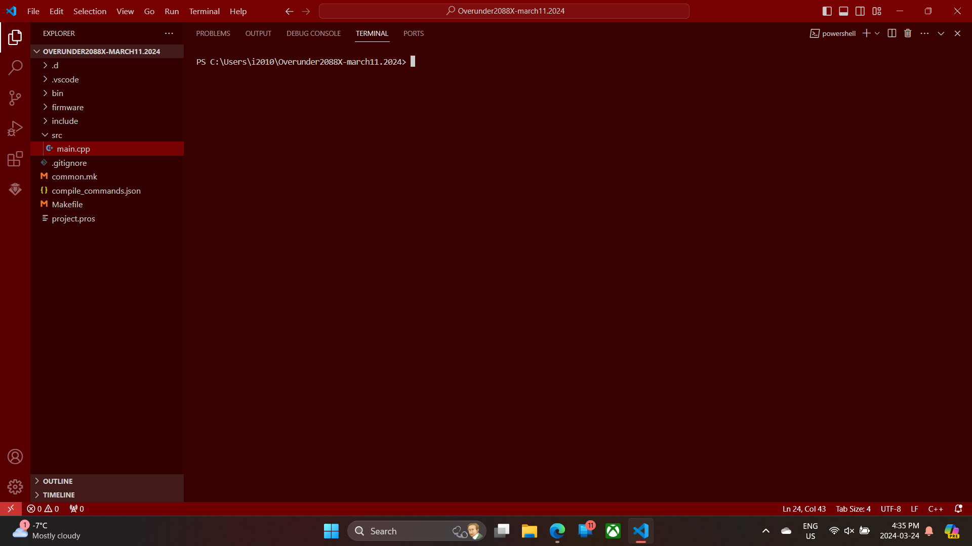

Idk why but my terminal is like this in visual studio help pls
Like idk why it is a “powershell” and not pros terminal. why is it like that

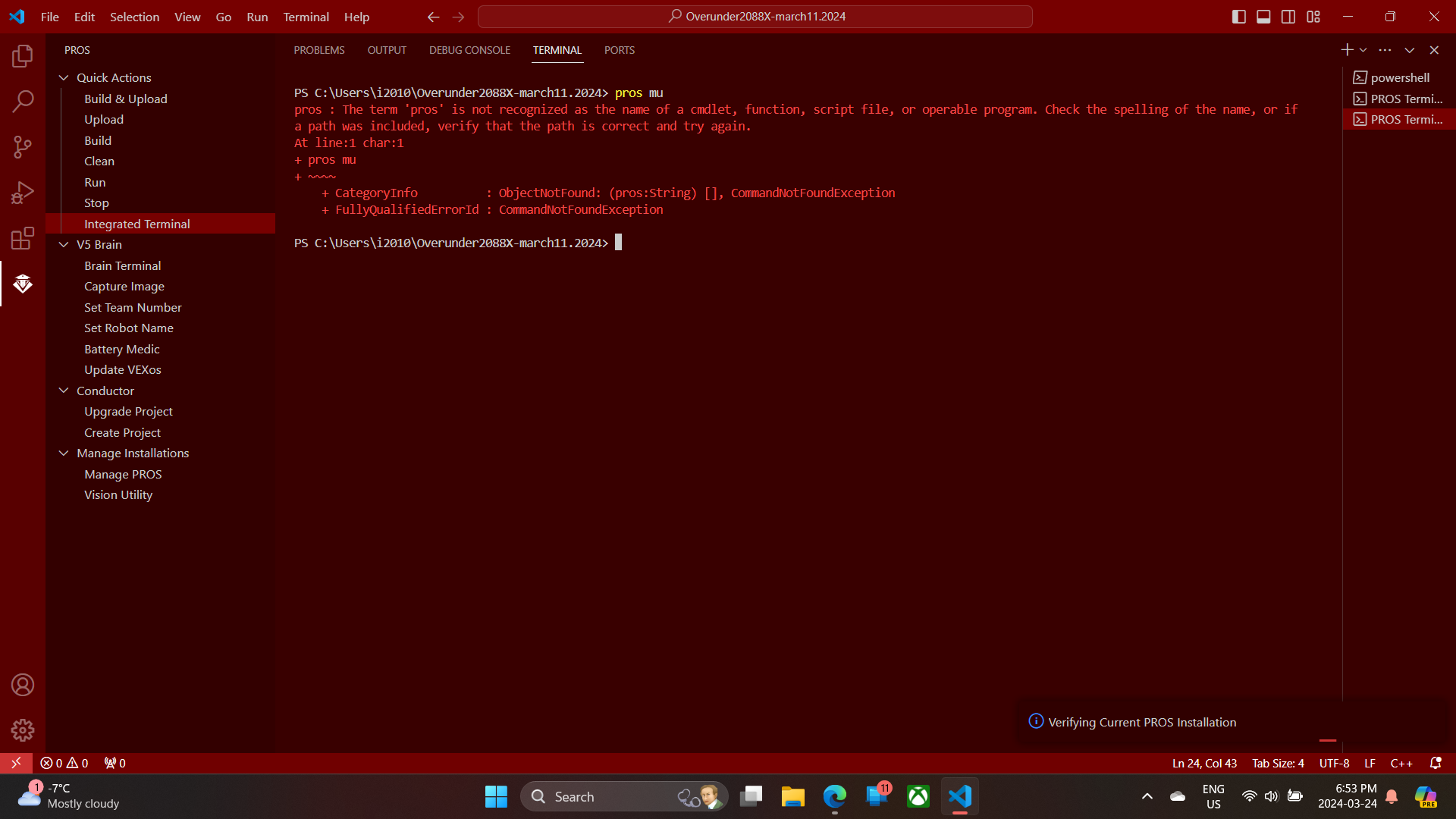

Click on the PROS icon on the left then click on “Integrated Terminal”.
for some reason its giving me this when i try to upload my code.
Looks like PROS isn’t fully installed, judging by the bottom right. Someone from the PROS team will probably have to jump in. This wouldn’t happen to be a school laptop would it? Sometimes the software and network restrictions on those can cause issues.
Ill check to see if everything is installed. im not sure though because it worked before. and this is my own personal laptop
In the sidebar, click Manage PROS Installation → Uninstall PROS. Once it’s done, restart VSCode and then install PROS using the prompt that will pop up after it finishes verifying.
If you’re also asking about why it’s fullscreened, you can usually just drag down from the top or open another file to bring the text window back.
