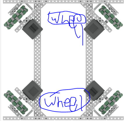

My team is using X-drive and it works amazingly, to fix all cons you just need to put wheels in the middle part to get over the bar on the field as shown in the image below -
Capture

X Drives are usually bad at pushing, because a traditional x drive can only have 4 motors while a lot of teams prefer 6 motor drives, and x drives are actually sqrt(2) times faster and weaker then a normal drive with the same wheel speed. You can add in more wheels and motors like koen suggested, but this makes the drive a lot heavier and complex, on top of the already complex normal x drive. You also can’t gear together all of the wheels on the drivetrain, meaning if part of your robot get lifted off the ground (like by another robot’s wedge), the motors attached to wheels which are off the ground are no longer helping the robot drive. X drives also reduce the space at the front or back of the robot to fit an intake, forcing you to make a big robot for a game with an already cramped field. And specifically for over under, x drives are a lot harder to climb the barrier with.

X drives have a much harder time climbing than other drives. This is why x drives weren’t used in TiP but were a bit in SU and CU. Over under is probably the most climbing focused game since TP so it makes sense for x drive to not be used.

X drives cant climb barrier. X drives generally have less torque. X drives are harder to program. X drives cant have a 6m drive withought some asteriks drive goofiness. There is a reason why tank drives are the meta.
x drives struggle in VRC because you can only really take advantage of the strafing abilities in a match at higher RPMs. i found that 360 rpm 4m for x drive is the cream of the crop for x drive as it runs about 400 rpm due to the goofy math involved. but then you run into the lack of torque issue and as you stated, asterisk is the only way to counteract that
I posted a drawing of an X-drive that can get over the bar, please read it. It does not have many cons and it gets of the bar quite well, it also uses 6 motors

The x drive I built has an intake and space for a catapult (in the future) and we made it relatively small
