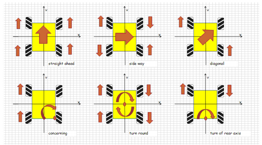

Why won't my mecanum wheel drive base strafe sideways but simple rotates slowly?
We currently have a team that has only a solid 16 in by 16 in drive base that has 4 mecanum wheels each connected to a motor. The code and wheel formation is correct but it rotates slowly. I have been wondering if it is a weight issue as the only weight currently from the v5 screen,the radio,and battery. Base has been tested on many surfaces and has been double checked for resistance but none found. Does anyone else with more experience have any ideas?IMG_3962

your wheels need to move either move away from each other, or towards each other, I imagine you have one side of wheels. moving correctly but the other side is turning the same direction
so you need to make the back left wheel spin forward, the front left wheel spin backwards, the back right motor spin backwards, and the front right motor spin forwards to make it strafe (either left or right, idk) and then just reverse all the directions to strafe the other way.
When strafing:
left front and right back motors spin one direction
left back and right front motors spin the other direction
Also, you might want to check your config file. Maybe one side’s motor rotation direction is set to false
So then the wheels don’t spin with one side spinning inwards and the other going outwards to strafe?
There’s also lots of great videos on youtube about the subject, from how to properly install the wheels, to a code outline on the algorithm that mechanum drive needs. Hopefully this helps😄
@Ben_Vandeburg, Mecanum wheels come in complimentary pairs: left and right. It makes difference how you mount them. Wheels on your base need to be flipped.
The pattern should look like X from the top and like <> when looking from the bottom.
This is the expected top view:
