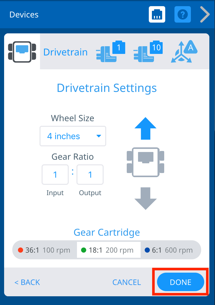

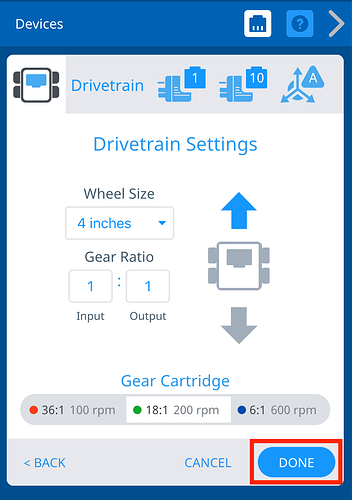

If you know the gear ratio you can specify it in the drivetrain creation.
The most important thing is you get the size of the wheel right and the gear ratio or the distance will be off.
Other stuff is more for turning.
Ignore the red box it’s from a drivetrain creation tutorial.
We use omniwheels. arent they the regular 200mm wheel size?
Also in your screenshot what is that about Gear Cartridge? we dont see that when we configure our drivetrain
Could you send a picture of what you see when you try to create a drivetrain?

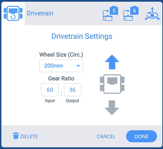

Yes, the OmniWheels are 200mm for travel. The screenshot @Mavric posted is from V5 VEXcode, not IQ VEXcode, and those motors are very different. Your IQ config screen will look more like this:
Sorry, I forgot IQ would be a little different without the gearbox.
