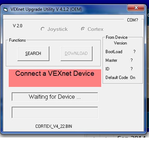

Sheapuck,
Its actually possible to upgrade the firmware on the Microcontroller/ Joystick, without the need of using programming software.
Can you please attach a screenshot of the utility you are using to upgrade the firmware? Once I have such screenshot I will be able to point you in the right direction.
PS- I suspect the issue is being caused by a missing driver in your PC.
-Eli
Eli,
I attached a JPEG of the utility (i think) when trying to update the cortex or joystick. The computer makes a noise that it recognizes when the USB is connected with the device but there is no change in this display whether the joystick, cortex, or nothing is plugged in. Last night I checked and updated the drivers on my laptop and that did not change. I have been doing it at home since it may be a bit of a procedure to get the firmware and install it at school.
I really appreciate the help.
Tim
Sheapuck,
Depending on your PC, please manually install the 32-bit or 64-bit driver found here. After such driver is in place, the VEXnet Upgrade Utility will be able to identify & download into the Microcontroller and Joystick.
Let me know your results.
-Eli
