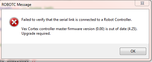

Hello,
I ran the edited code that you gave me and it still doesn’t run without the USB cable from the laptop to the cortex. I get an error like this(attached) when I connect the VEXnet USBs to the laptop and cortex. I have the USB cable running from the laptop to the controller.
I am not sure if this configuration is correct! And all the Firmwares are up to date as far as I checked. An amateur to building robots :slight_smile:
Could you please take a look at the error message and guide me?
You need to upgrade firmware on cortex and joystick, this is (usually, if it doesn’t fail) done by plugging the orange USB A-A cable into the computer and cortex, performing the firmware upgrade through RobotC, and repeating that with the joystick. Then make sure that the joystick and cortex are paired and connect to each other (green LEDs) when the the VEXnet keys are inserted into them and everything is turned on.
Do you have one of these cables: http://www.vexrobotics.com/276-2186.html
If not, you will need to download the code by plugging the USB cable into the cortex and computer, download the code, and then plugging the VEXnet key back in to the cortex and joystick so they connect with each other. VEXnet keys won’t let you download code when plugged into the computer, if you want to download code wirelessly you need the cable linked above.
Let us know if you need help with any of those things or if it doesn’t solve it. Also, if in doubt, power cycle often.

I tried connecting the cortex and the remote controller after assembling the clawbot and the joystick worked fine.I was able to test the motors and stuff with the default joystick code. This was even before using ROBOTC software.And this was a long time ago, like 2 weeks back. I didnt use the joystick at all after that till today. So has it got anything to do with my code that I have posted above?
After trying to download the code using the USB A-A cable and after connecting the VEXnet keys to the cortex and joystick, the VEXnet LEDS were just blinking green.:frowning:
Well after downloading the code connect the remote and cortex using the orange cable and try driving it around with the new code if that works then it means there is an issue with the keys be it what version they are on or something else. If when plugged together with the orange cable the lights don’t turn green then my first step would be to go through the firmware update utility and update both the remote and cortex to the latest versions, that generally fixes most problems I encounter with stuff not connecting.
Connect your joystick to your computer.
In ROBOTC go to the “Robot” menu, then “Download Firmware”, then Click on "Automatically Update VEXnet Joystick"
After the process has finished, disconnect your joystick from the computer and connect the Cortex.
Perform the same steps as above but select “Automatically Update VEX Cortex”.
After this has happened, power cycle both the controller and the cortex and re-pair the VEXnet connection by connecting them together with the USB A-A cable for a few seconds till the lights turn green on both.
NOTE: You must re-download the code from ROBOTC to the Cortex after you have updated the firmware.
If you are still having issues you may need to update the firmware on the VEXnet keys.
To do this, download and install the VEXnet Key 2.0 Firmware Utility) from here http://link.vex.com/downloads/VEXnet-Key-2p0-Update
This will only work if you are using the 2.0 keys
You must complete the process for each key, instructions are available here http://link.vex.com/docs/VEXnet-Key-2p0-Firmware-Instructions
If you are still having issues you may need to contact VEX technical support via email at support@vexrobotics.com

My code has both autonomous and user controlled tasks. Task 3 (Driver challenge round) is started when LCD button 4 is pressed. It has to be then operated by the controller and it should execute Task 3 of the code where the LCD has to show he number of balls picked up.
Is my code correctly structured or I need to add some functions like user_control() and change the template? Also do I need to code the joystick buttons or maybe just assume that it will run on its default code?
Could you please take a look at my code and let me know? Task 1 and 2 are autonomous tasks and task 3 is executed when LCD button 4 is pressed. But the robot has to be controlled by the controller to pick up balls.
task autonomous_1()
motor[port1]=0;
motor[port10]=0;
wait1Msec(10000);
//bMotorReflected[port2]=1;
displayLCDCenteredString(0,“Have a nice Day!”);
SensorValue[LeftEncoder]=0;
SensorValue[RightEncoder]=0;
//motor[ArmMotor]=63;
Straight();
repeatUntil(SensorValue[dgtl10]<=2);
stopAllMotors();
task autonomous_2()
displayLCDCenteredString(0,“God s Great”);
while(SensorValue[in2] > 2250) // Center sensor sees black
Straight(); // Goes forward
if(SensorValue[in1] > 2300) // Right sensor sees black
TurnLeft(); // Turns left
if(SensorValue[in3] > 2300) // Left sensor sees black
TurnRight(); // Turns right
task driver_challenge ()
motor[port1]=0;
motor[port10]=0;
int ball_counter=0;
int pressed=0;
while (true) {
clearLCDLine(0);
clearLCDLine(1);
displayNextLCDString("Count:  ")
displayNextLCDNumber(ball_counter)  //check what the 4 is for
 pressed_button();
   if(sensorvalue[dgtl4]==1){
   released_button();
   ball_counter++;
@GeroldaffeTheGiraffe , We didnt swap them yet! But our VEXnet keys were working fine when we tested the basic functionality of the motors using the controller, after the clawbot was assembled. This was before downloading any ROBOTC code.
Thank you so much!
