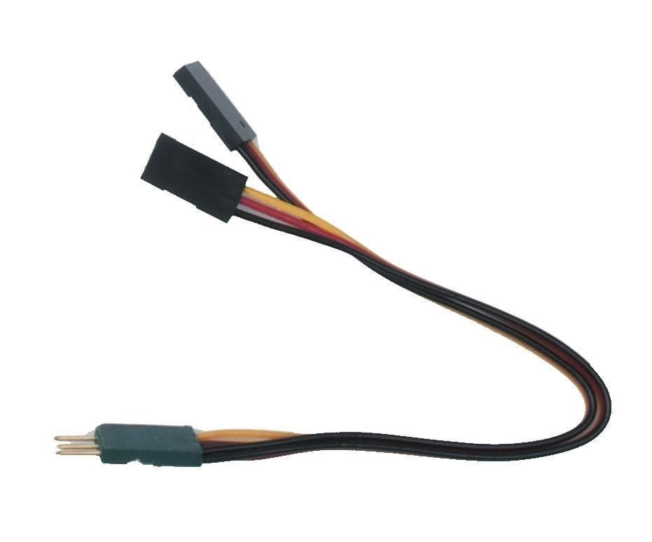

Our robot is having some problems with the wiring. We plugged a motor wire into a sort of extension piece, and plugged that into another extension that can take 2 motor wires. We basically took 2 motors and combined them into 1. When we plugged it into the cortex, only 1 side worked. Do you guys have any ideas on what we can do? We already tried a different motor and the coding is fine. Thank you.

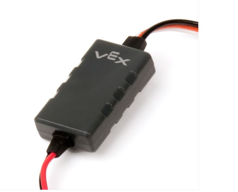

Is this what you are using?

#7
yes we are using them.

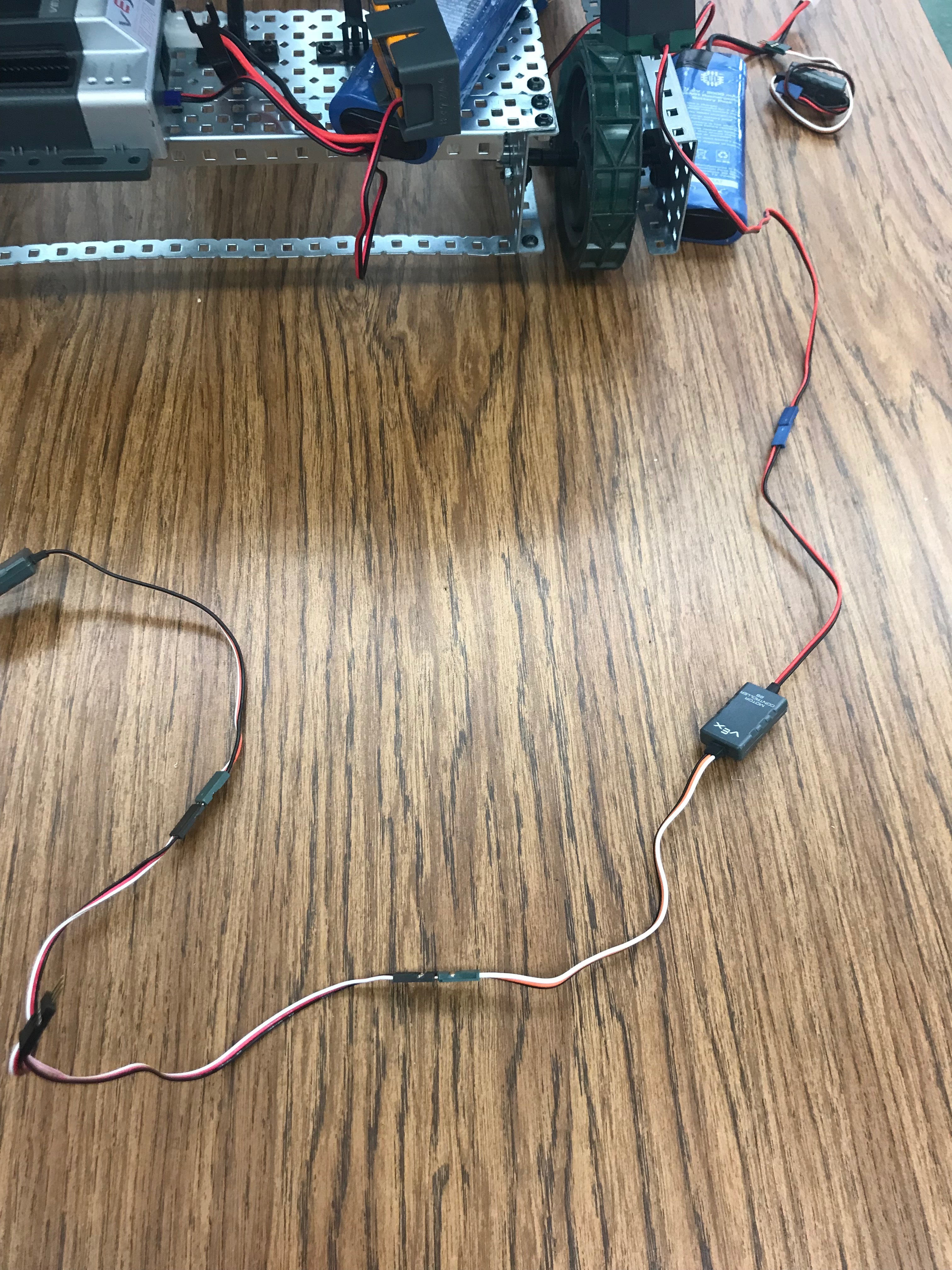

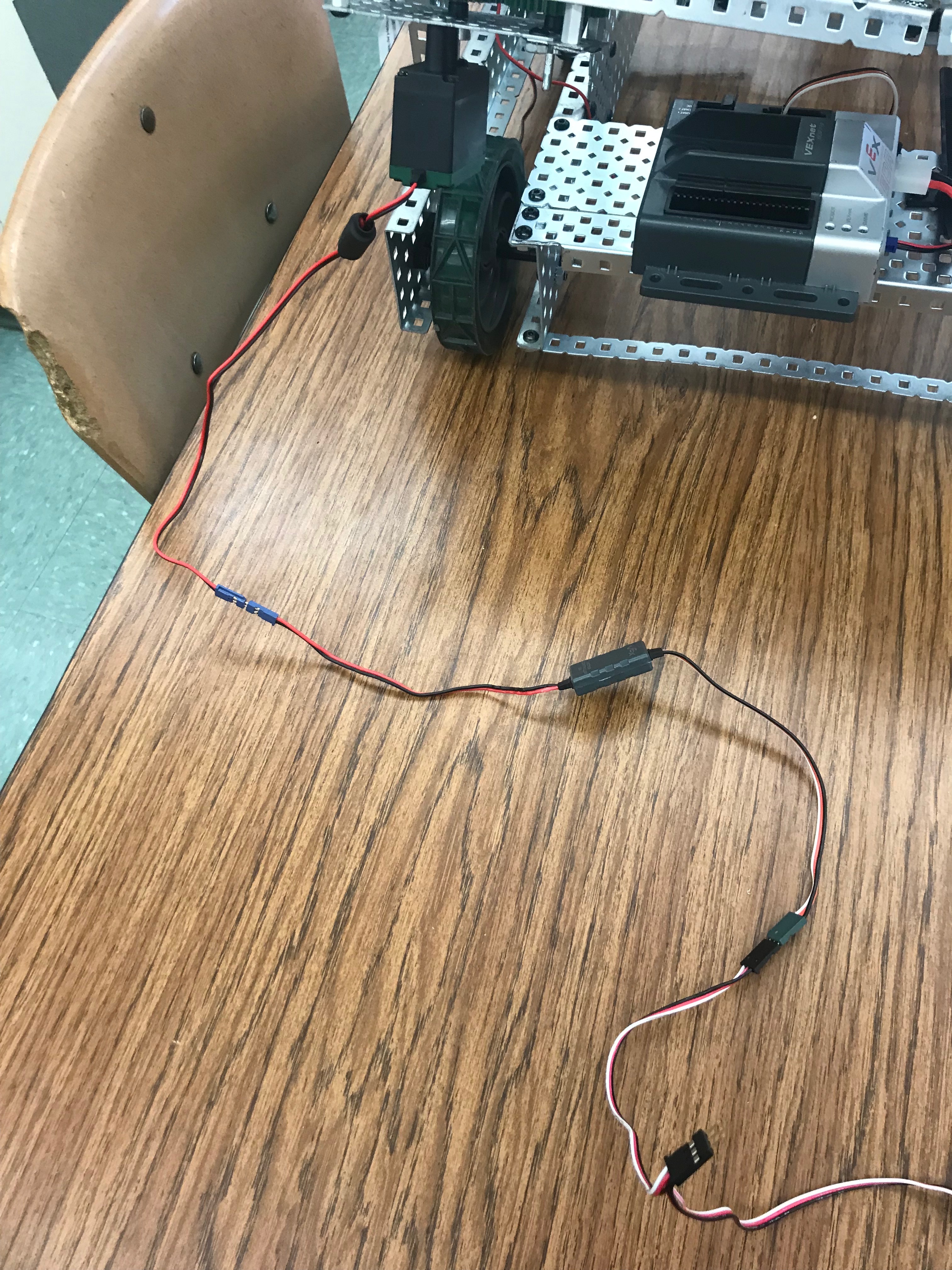

Send a picture of your wiring

#13
IMG_0813%20(1)
IMG_0812

#20
Ok give us a little more description, when you swapped the motor controllers, please tell us what happened? did either motor run? I can’t picture ‘worse’. I was wondering if the motor that worked before the switch did not work after the switch? and if the motor that didn’t work before the switch started working? or still did not work.
When you tried one at a time how did you wire them up? still with the Y cable? can you try each motor without the Y and see if it works.
With respect to the code… is it the code posted above in the thread? Which motor are you having trouble with?
