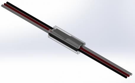

I saw this thread on the forum and it shows a small 3d printed box that could be potentially used for wiring. As said in the thread it is not legal, however I think that this idea would be useful. My proposal is that VEX design something similar to it or that does has the same function. I know that I have have had a few problems with the pins bending and almost on the connectors while Zip-tying, this would be a simple and easy fix.
https://vexforum.com/t/answered-3d-printed-parts-legal/25332/1
This type of thing already exists (although not VEX and therefore still not legal).
A couple of random links.
https://www.troybuiltmodels.com/items/TBMWCLIPS.html
http://www.rcaccessory.com/safetyclips.aspx
I do agree that it would be a useful accessory for VEX to sell.
I would no longer have to tell countless Middle School teams at competitions to zip tie their connections because I’m positive they’ll come undone. I like the idea as a product for VEX to sell.
I second(third?) this. I would really like this. PLEASSSEEE VEX
Yes, for sure, something like this would be amazing. The ones linked to above would be good and look like they would fit VEX wires. This way IFI can use a current product and doesn’t need to make new molds and what not.
If they do end up custom making something, I would like to see some sort of hard plastic covers, one on each side that are solid. When you put two together and zip tie it, it will prevent them from bending and have a piece over lap over the end so they can’t pull apart. This way it would prtect the connection and prevent you from having to do the zip tie around the two plugs that may damage it.
We’ve already broken the pins off two motors, so these would be helpful. After the season I will see if something can be done out of the polycarb. :slight_smile:
Make it unanimous!
me too. The night befor the last competition(we are really good at procrastinating) we were wiring our robot and two motors had the pins break off inside a 2-3 wire converter, a real problem considering we had to get a new motor and converter. PLEASE VEX, give us something better, even if only a better motor connector, perhaps something where the plastic and metal both interlock, so that it is harder to break.
we could also take a small piece of Plexiglas(legal) and zip tie it in place
Some thing I think is legal is to wrap electrical tape around the connected to hold them together. Although I’m not sure if it is legal because it isn’t a vex part. I have seen teams do it, and not break the pins.:slight_smile:
Yes, that’s legal. I’ll find the rule eventually.
The thing is that they can still bend and possibly break, not to mention it isn’t necessarily very neat. Some part to put around the connection that’s solid would be much better.
