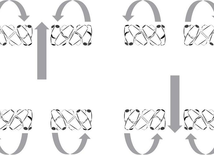

I have a 4 motor mecanum drive with 1=1, elevated chassis too, but I can get over any bump of similar dimensions, even one created from the vex 5x25 plates and some 1x2x1x25 C bars. I can also almost get over an entire 2x4 - (the 1.75 in side)
also make sure you are using the corect wheel orientation and the correct programming.
