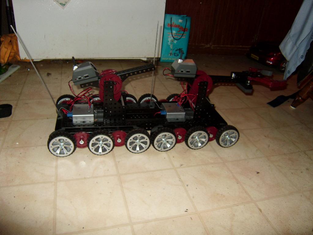

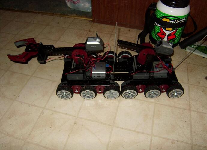

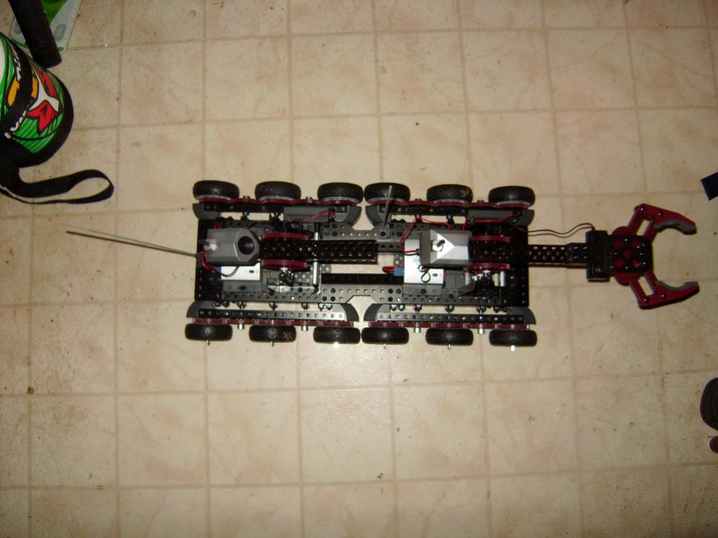

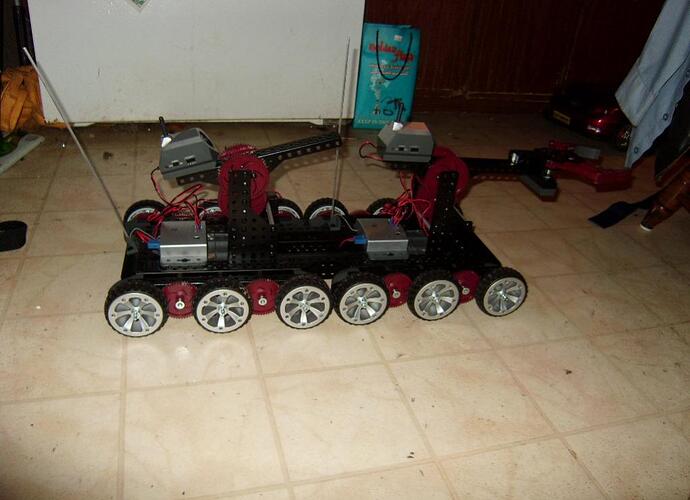

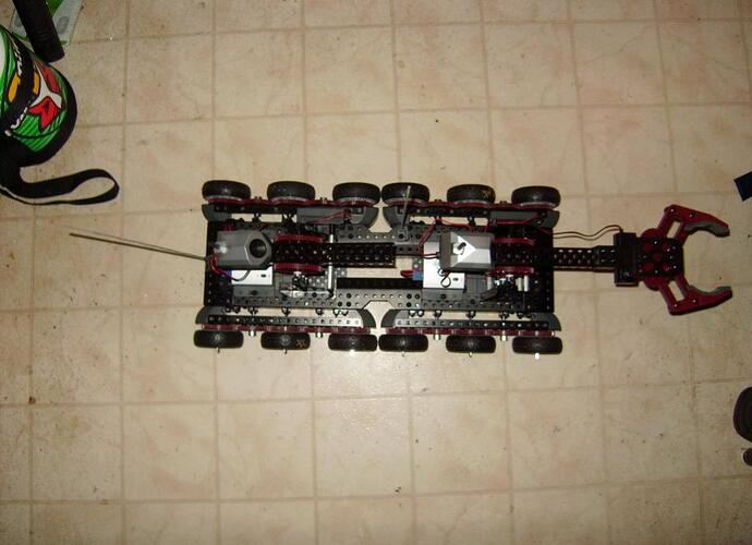

Here is my first bot. I bought 2 Vexplorers from woot because they were $79 each. I had been considering buying one before butat that price I could not resist. I was going to give one of the kits to my Nephew but he had been kind of naughty so I gave him a lump of coal instead .

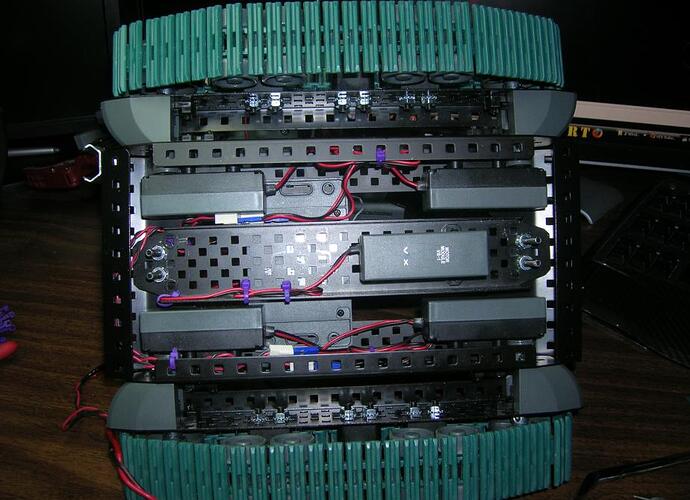

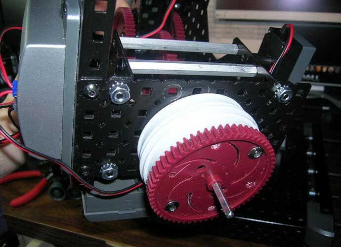

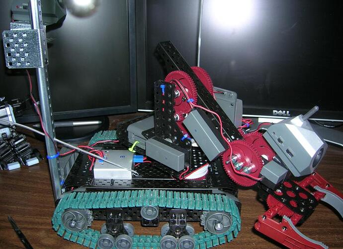

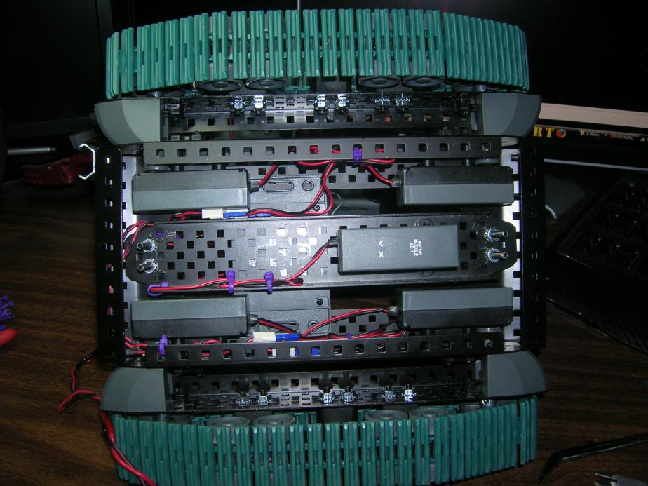

Once I had the kits I began to mod the claw support assembly so that it would rotate. I did this by super gluing a 60 tooth gear to the hub of one of the Vexplorer wheels to gain stability I then ordered the tank tread kit and as I had a total of 8 motors I gave the tread 4 motors in order to accommodate the increased weight.

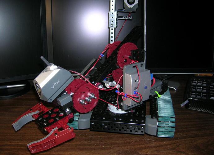

The final step was to make a 'wrist" for the claw. I did this by replacing the 84 tooth gears shown in the kit sold with two 60 tooth gears that I drilled 2 holes in.
I had to experiment with finding an optimal balance for the the claw but with testing I have achieved a decent balance.
The resulting bot works very well although the turret rotation could be smoother.
I bought a dual control starter kit that I found on Ebay and I am awaiting delivery. I also bought 4 speed controllers so I can use my Vexplorer motors with the Vex microcontroller.
Whoooot !!!
Very good building and great pictures, thanks for posting them!
Very impressive for your first robot! I like the dual camera idea.
Yeah i got bored with my Vexplorer and did the same thing with mine except i didn’t use the wheel and gear kind of thing. Mine uses an 12 to 60 gear ratio and the assembly is on a 15 x 5 plate. The only problem with mine is the arm is about and inch above the whole chassis and is probally not as stable as yours is.
Yours still is AWESOME though!!!

I did think about hinging the chassis and I want to put 2 sets of tracks so it will not get stuck. The turning is not that bad on a vinyl floor but when you get it on carpet or anything that is not smooth it drains the battery. Moves like a slig when it turns right now. I am going to try to put a ball hinge on it so it will be more agile. I am going to ace and radio shack today to get some more parts for the launcher. I will post more pics soon.
