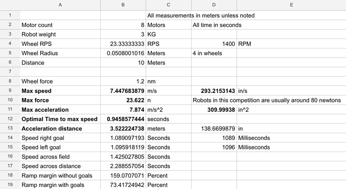

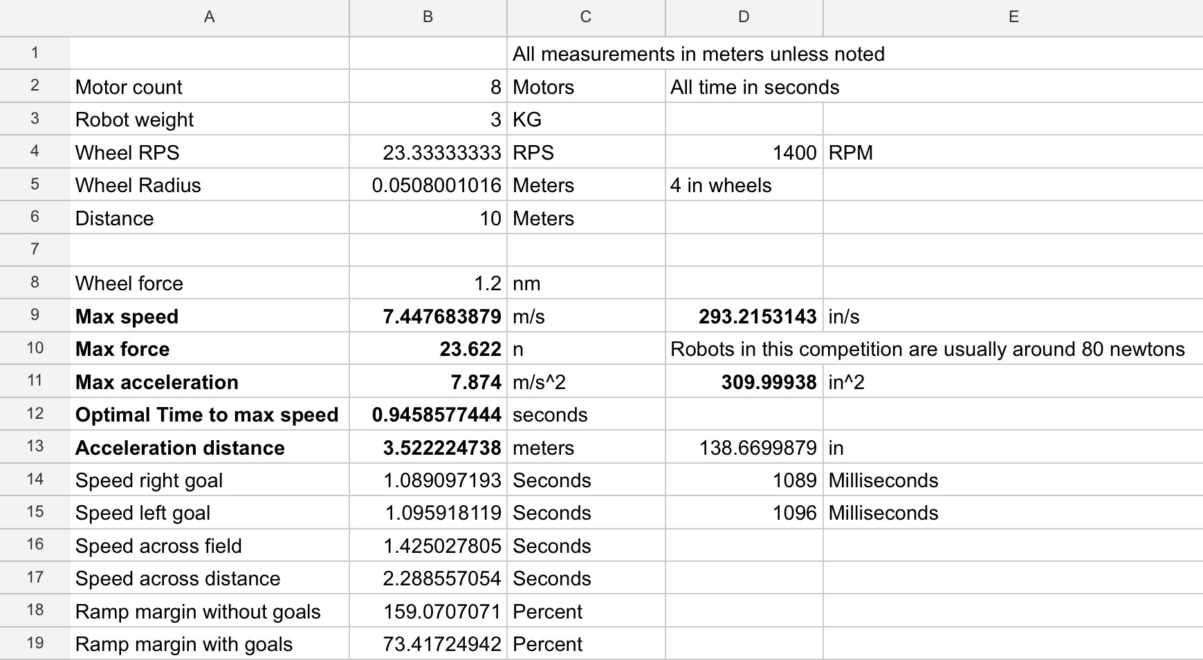

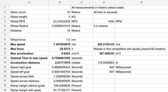

I put some numbers into a spreadsheet I made for analyzing drivetrains and here are some of the results I got. I think that to get any reasonable acceleration you will need at least 8 motors. All calculations were done assuming that the drive was 4in and 3 kg. This is a lot of data, but all of the important values are bolded.
4 Motors:
6 Motors:
8 Motors:
10 Motors:
12 Motors:
20 Motors(Why not?):

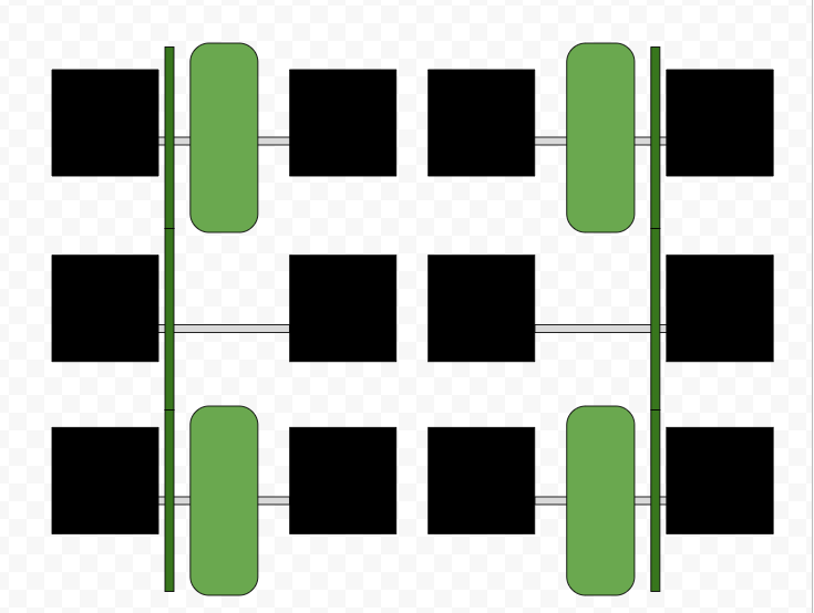

Here is a sketch of what a friend of mine is making. He hasn’t added the exterior motors yet, and I don’t know if he will.
