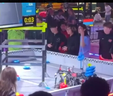

Do you have the timestamp for this descore?

there is the clip. its a terrible angle. there is a much better video posted on discord but unfortunatey i cant uplaod a video file here.
so theres a fram by fram sorta
