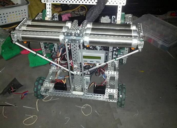

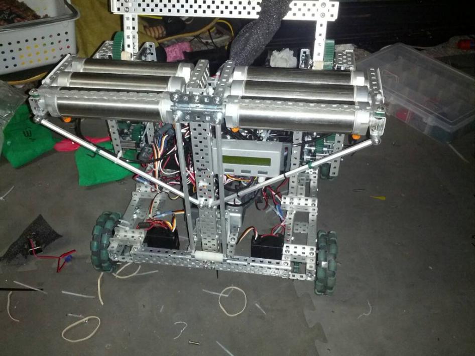

The reason I used standoffs in a lot of areas on my robot was just due to the lack of aluminum available. And the need for custom lengths that metal would just not work in.
Also I would not be so worried about making your chassis that robust. ( yes this is just a high school robotics competition and at most if it lasts 30 matches its good)Yes triangles are nice, and very structural but most of the time a rectangle works just as well and is simpler to build and attach other things to like your cortex and such. I’m not saying you should not worry about how strong and reliable your robot is, but time could be spent elsewhere.
Says the guy with cantilevered wheels.:smiley:

There’s nothing wrong with a cantilevered wheel. They’re easier to do wrong than dual supported wheels (too small bearing ratio can spell disaster), but when done right, as these appear to be, they work just fine, and add the advantage of pushing your wheels to the maximum possible dimensions of the robot footprint, increasing stability. And of course, changing wheels is a painless process with cantilevered wheels.
