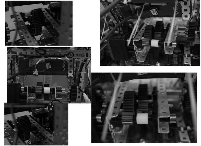

would this work?
This is Mr.Tangents “hook” mobile goal intake, i wanted to know if this would work with one standard high torque motor?Thanks in advanced.
A lot of teams are doing this with 1:7.
yeah i know i tried that, a 1:7 doesn’t fit on our robot.
@Echo_Robotics you could try 1:9 (1:3 compounded)
Here’s a video
- YouTube
I’ve also seen a team do 1:5 torque with full aluminum and 12 hole 4-bar
Thanks, but I just want to know if the hook would work.Our robot does not have much space so we need something compact, like the hook.
We do not know how your robot is like, so we cannot say if it would work on your robot, but I would suggest just trying it out It’s only a screw or two and 1 or 2 stand-offs.
Generally speaking, these sorts of questions are best answered by testing. However, some quick-and-dirty math can give you a ballpark estimation.
The worst case scenario for this linkage is when it’s fully extended forward and attempting to lift the nearly 3.7lb mobile base. From the perspective of the motor, it is attempting to lift the base at a distance of d inches from its axis of rotation, where d is the length of the c-channel attached directly to the motor. (I’m ignoring the weight of the arm here as well, which really shouldn’t be omitted… so, we’ll just round and say that the weight is 4lbs instead of 3.7lbs.) In this configuration, you’d be experiencing torque of (4lbs)*d. So, if that distance is about d=7.5 inches (I can’t estimate very well based on the video), you’d be experiencing about 30 in-lbs of torque.
That’s a lot of torque! But you have a 5:1 gear ratio, the motor would only need to provide 6 in-lbs of torque to lift the goal. Looking at the motor efficiency curves that jpearman so helpfully posted years ago, we see that this is well within an efficient, low-current range for your motor.
Of course, if your hook weighs more than 6oz, or if my estimated distance is wrong, my resulting numbers might be a little off. I recommend you try doing the math for your robot configuration, but my back-of-the-envelope calculations suggest it’s worth a shot.
EDIT: I’ll also note that I straight-up maximized the torque experienced by the motor, rather than looking at the torque at a particular angle; e.g. if the motor’s linkage is at t degrees above horizontal, then the torque experienced at that point would be (4lbs)dcos(t). So, if you don’t fully extend the linkage, it will take less effort to raise the arm again.
