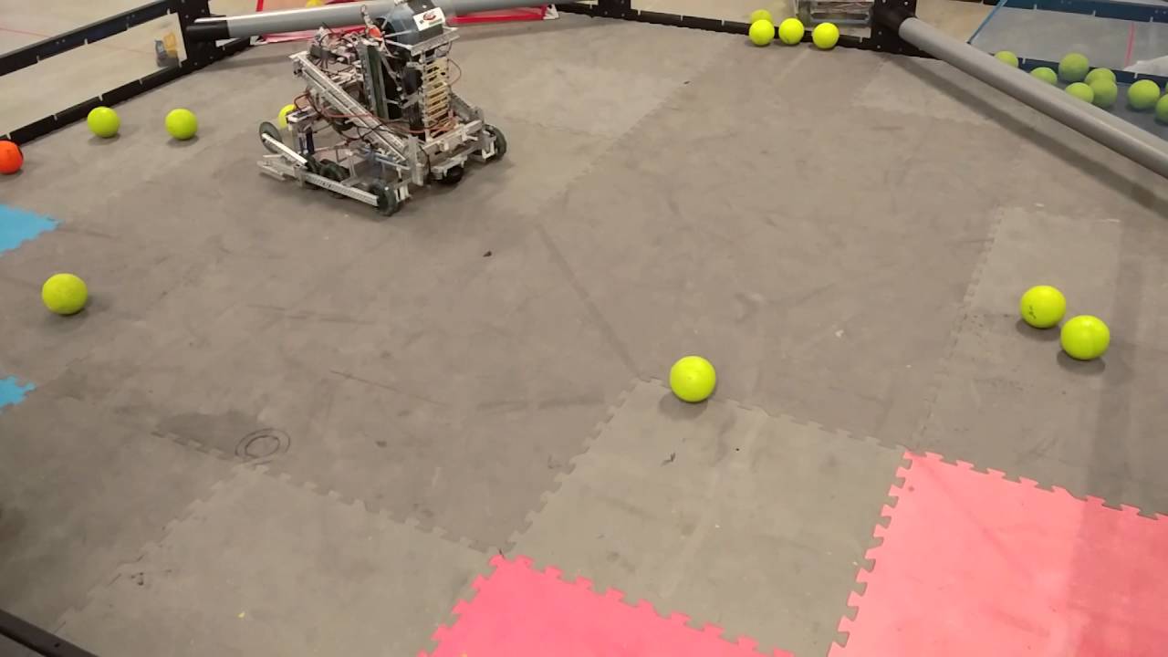

So Team GOAT would like to present some explanations of its Lidar code that ran at the VEXU world championship. We thought it would be a fun interesting challenge to make a dynamic autonomous(auto located balls around the field and pick them up) that we had programmed ourselves 100%(I believe it was the first fully autonomous individually programmed vex robot ever). This is obviously a difficult challenge in its self, but what made it even more difficult is we decided to forgo any additional processing power and did it all on the Cortex in ROBOTC. I would do a full code release but the issue is that we wrote it all in the span of 3 weeks and there are lots of hacked together and or bloated aspects that are not something perspective programmers should be exposed to. (If anyone wants to play around and explore it I can add you to the private git repo) So instead here is an explanation of the steps that went into autonomous locating balls.
To ensure accuracy steps 1-4 were ran 3 times and a ball was only confirmed if 2 of the 3 iterations through a ball was computed to exist

Here is a video of it finding a few balls and shooting them. Given enough time and a full field it could score most of the field into the goal. Right after this test I realized my PID loop allowed the robot to stop driving straight if the error alligned perfectly between 80 and 100 mm away so ignore the little derp on the first ball. This is also before extensive work speeding everything up. The speed is still limited by single balls and lidar processing speed.
The robot actually accurately distinguished between a robot vs a ball which is why so much filtering was required. The picture of live data was when the robot was surrounded by tons and tons of balls, kinda a ridiculous example. I will have to see if I have any pictures of raw data that isn’t staged.
