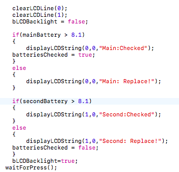

If I were you, I would go back to the default template for some simple debug testing. For instance, this is what my team had last year and it seemed to work just fine. In addition, if you go to “Sample Programs” in RobotC, you can find an LCD program that works perfectly fine.
