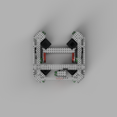

This is a cad of an x-drive that is 14" wide and 14.5" long. The ball fits between everything except the motors themselves, which they can easily go over.
You could also extend the motors for the front two wheels so that they are not so forward, allowing you a much less-steep ramp.
