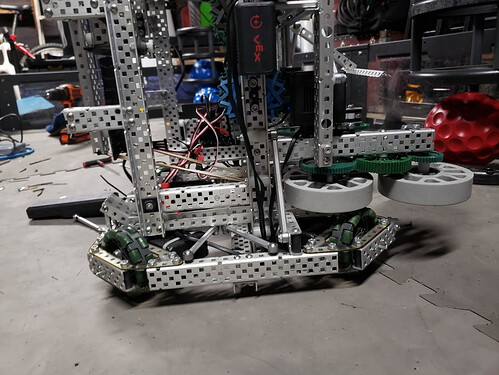

Can you pls show me how you’ve mounted your intakes to your x drives? I built mine but forgot to leave a spot for them. I’m looking at a rebuild bc if this and I want to see how I can do better next time. Thanks!
We have ours mounted and braced to our indexer towers:
