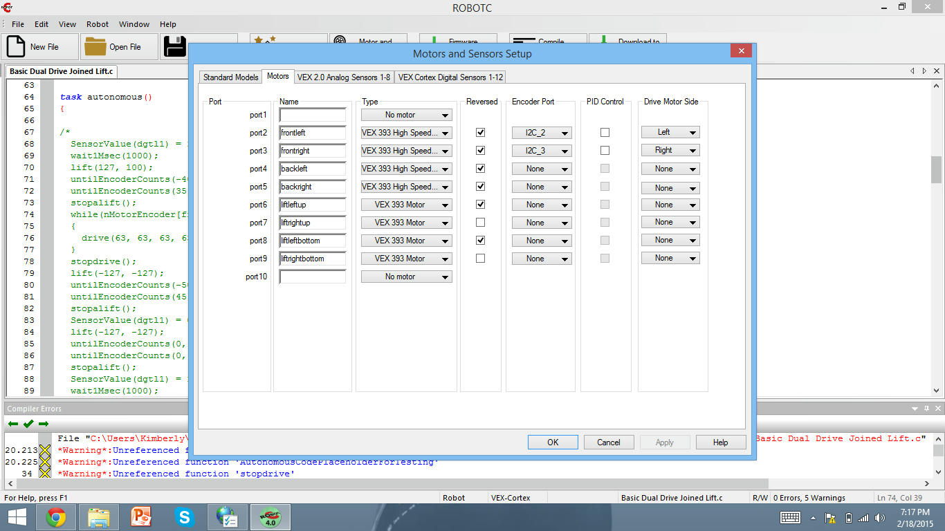

Give me an exact account of how the motors are wired including the polarity of the H bridges, and screenshot your ROBOTC motor config.
The H bridges should not switch the polarity, make sure black goes to black and red goes to red.
Also, all of our motor connections are not inverted. as in we have the black wire to black wire consistently throughout the entire robot.

This code will work on any “x” holonomic drive, as long as the motors have already been reversed correctly in Motors and Sensors Setup such that positive motor power leads to forwards movement. An easy way to determine whether or not any of your motors need to be reversed differently is to use a program such as the following:
task usercontrol()
    while (true) {
        motor[frontleft] = motor[frontright] = motor[backleft] = motor[backright]  = vexRT[Ch2];
When running this code, see if pushing the right joystick forwards makes the robot move forwards. If not, determine which wheels are spinning in the wrong direction, taking note that the associated motors need to be reversed. Reverse those motors in your original software through the Motors and Sensors Setup.
Use my code uncheck all the reverse chechboxes AND set the sides all to none in the motor cofig. Then swap back left with back right in the config.
Then verify that
Port 2 goes to the front left.
Port 3 goes to the front right.
Port 4 goes to the back right.
Port 5 goes to the back left.
Also be aware that the left stick is movement and the right is rotation. This can be changed after we get it working obviously.

Thank you. We have finally gotten it. After another hour of trying to figure out how this works, I got it to work correctly. Do you have any explanation of HOW exactly the code works in this way? Like how it goes
