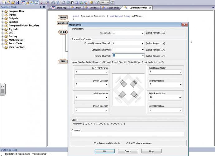

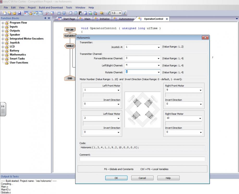

Bearing this in mind, I opened a New competition program and clicked on operator control tab. Then expanded the joystick menu and dragged and dropped the holonomous option. Then I saw what the .jpg shows.
How do I set it up?
I can’t seem to figure it out!
Thanks in advance!

You haven’t posted your code that you tried, not even the first one.
The picture you posted is the default Holonomic setup, which does not include channel 2, but you said channel 2 was doing something.
Post your code if you are stuck. include a picture of your robot would also help.

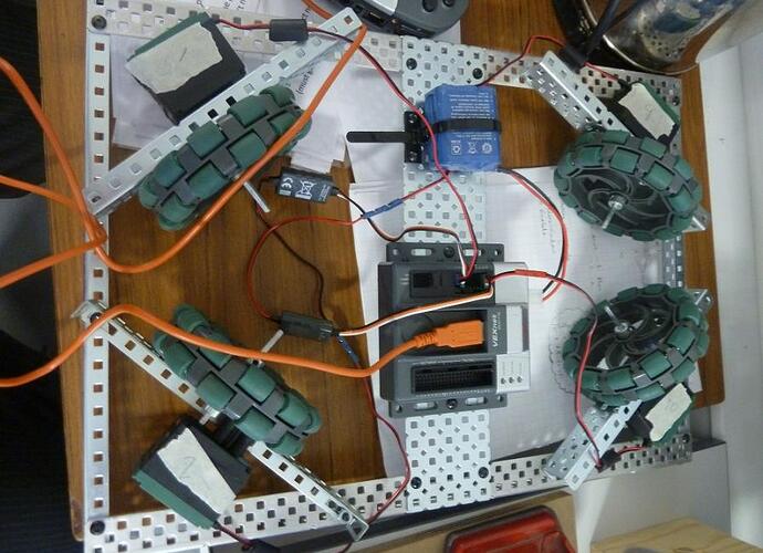

Ok so I set the motors up on easy C to all NOT be inverted. Then downloaded the program. (you can see my robot on the 1st pic).

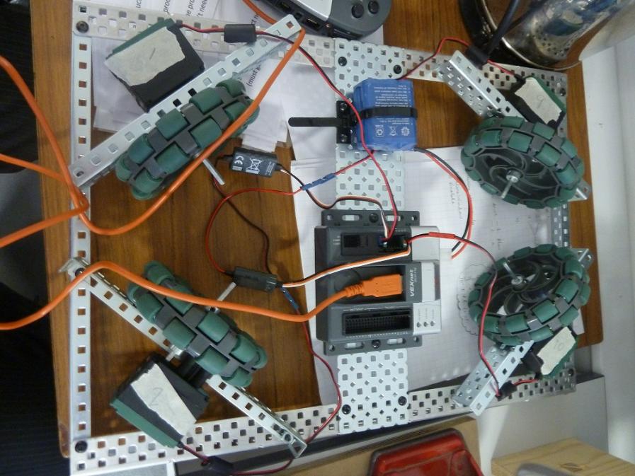

Based on your pictures you are going to have issues for two reasons:
1.) As you said…its too light. You need a bit of weight that is evenly distributed to get a good test of most x-drives.
2.) Your X is not an X. All wheels should be equal distance from each other. I’m sure it can technically work like you have it, but you are going to have all sorts of problems I think. (you have have a rectangular frame, not a square)
I would personally do the testing by actually monitoring which directions the wheels are moving when you request certain movements…not the robot itself.

So I gave in and created the holo block in EasyC. It looks like perhaps with a correctly wired robot then nothing is inverted (i.e… EasyC takes care of logic internally), but, as Cody so elegantly pointed out, you have at least one wire plugged in the wrong way (port 10), so… either fix that (with EasyC black wire goes towards vexnet key on ports 1&10, the opposite from ROBOTC unfortunately) or invert port 10 on the holo block.
With such a non-square design, and no weight, accurate from/back movement will not be so good.

Just get the wiring correct (red-red on the MC29 connections and ports 1&10 correct) and then the default of no inversion on the holo block motors should work I think.

Doesn’t go exactly straight but as you said I think thats because it’s rectangular.
I think this is the mistake I made. I thought it was going diagonally when actually it WAS going forward all along, but the frame shape was affecting why it wasn’t going ‘straight’.

Having a non-square design isn’t nominal, but it’ll only really hurt you when rotating, play with it and if it’s a real problem then I’d suggest going for a more square-ish design. If it’s not a real problem, you can keep it or change it, up to you.
I’ve seen non-square, and even non-45 degree holonomics, they’re funny looking but still work decently well.
