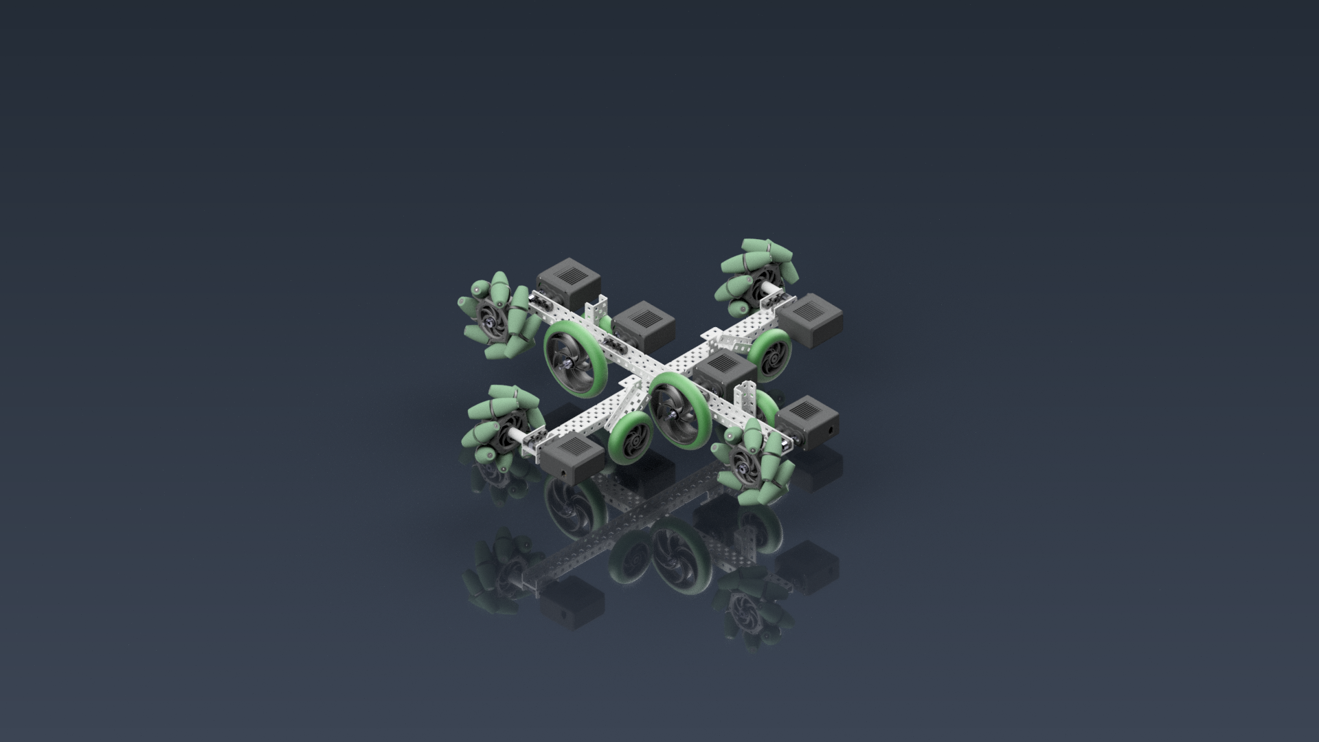

X drive problems with traction wheel
You are posting from an alt account, so if this is genuine post a picture of the robot.
Otherwise, well, you know what will be happening…

I do not physically have the robot but I did cad it. This cad is from before I had 12 wheels.

This looks a lot like my double reverse four thirds kiwi rocker bogie mecanum differential swerve drive, except without the swerve or bogie or double reverse 4 bar. That, in its current configuration, won’t move.

Here’s my solution (again, still giving the benefit of the doubt that this is not a troll):
Scrap that CAD, and make a new one. You’ll want to consult some sort of resource like this one, which will lay out some simpler drive designs that have been tried and tested. Then, using your CAD skills, try to make a drive more similar to one of those.

I agree with the other posts to start over, but if you have built this, then pull the small and large traction wheels off and just drive with the mechanums. You’ll see the issue with the way they are mounted and can use that as a learning experience.
Then replace them with omni wheels and see what that does. You won’t be pleased with the results, but it will be a good learning.
An FRC team (I want to say 148) built a combo mechanum / traction wheel drive base. They mounted the wheels on a rocker assembly with one of each wheel type on ends of the rocker. In one position it was all traction in the air, the other was traction down. This gave the ability to swap wheel types on the fly. Very cool and very complicated.

To be honest with you it seems overly complicated and very unnecessary. if you are competing in actual competitions then this drive will no be advantageous. You are left with 2 motors to do any other task required(which if you have they figured out than great!). the drive as you mentioned will not strafe. To fix the strafe issue i would rebuild the base into an Mecanum drive(since you have mecanum wheels). this type of drive will allow you to strafe and prevent you from being pushed sideways easily. it also gives you a square base which is easier to build off of and work with. The square base will also allow you to sandwich your wheels which adds strength and keeps the wheels from doing like this Uploading: image.png…

take out all traction wheels, add supports to your cross which the wheels are mounted to, and switch the meccannums to omnis.
