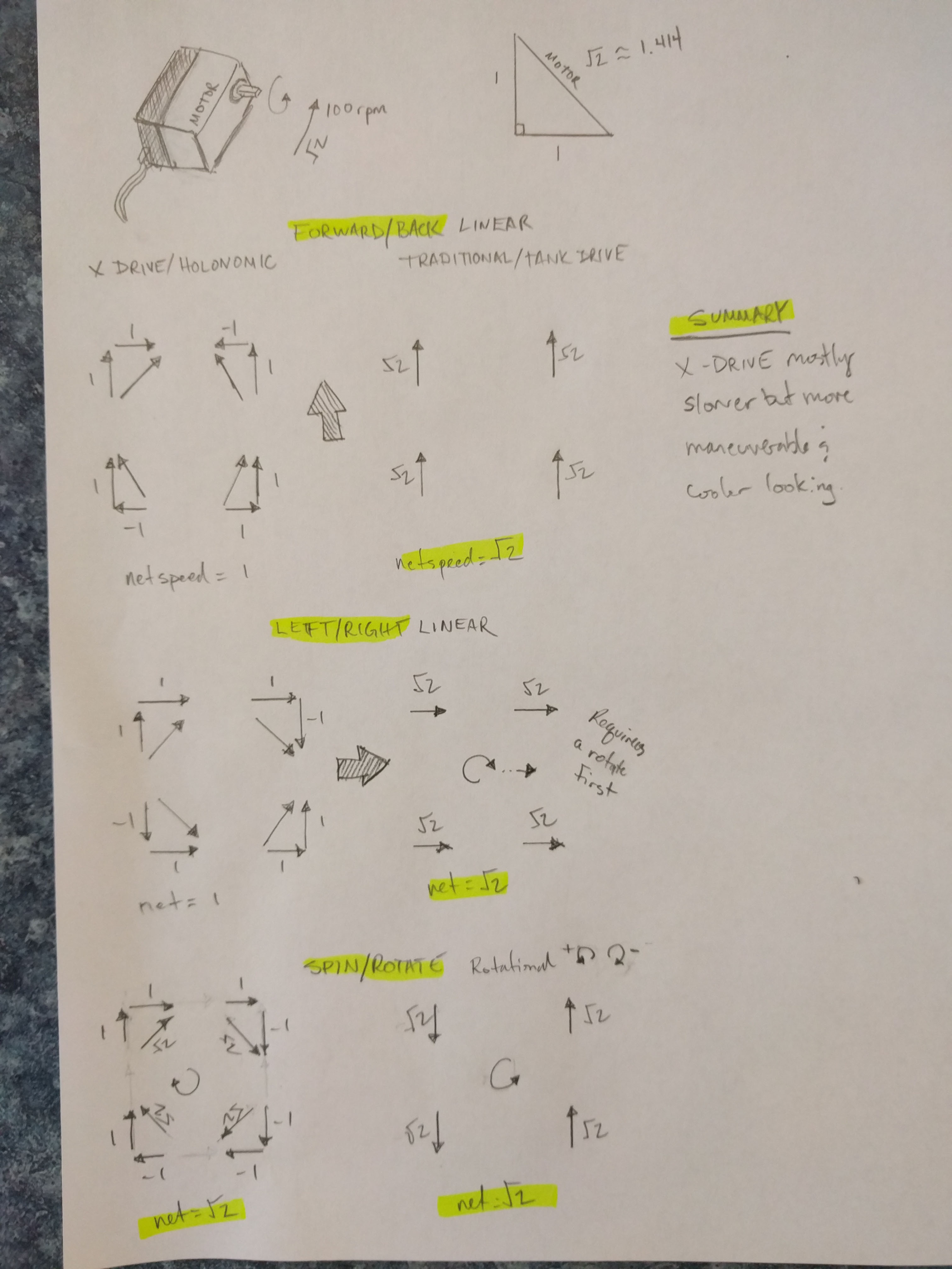

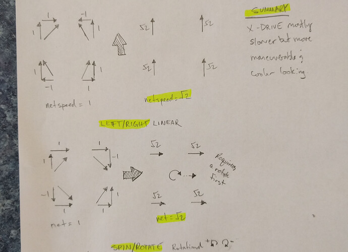

The original blog post is isolating one wheel and comparing travel while moving diagonally which in reality isn’t how you would implement the x-drive. I drew up an analysis which fills in all parts of the puzzle. When using the x-drive opposing vectors cancel each other out, so you must consider the net speed. I’ve come to the conclusion that the tank drive is always faster unless rotating in which case they are equal. The x-drive is much more maneuverable in general, unless trying to drive up a ramp.

Ok so after consulting with my physics teacher I have found that a tank drive definitely goes faster. You all are correct when you say that two vectors of 100rpm of one going north and one going east would create a resultant vector of 141rpm northeast. However this is not what is happening in an xdrive. The two vectors I just described are not fighting each other but rather act in conjuction with each other. In an xdrive the two vectors act against each other, canceling out the vector in the x direction, leaving two vectors of 70.71rpm in the y direction that you cannot add together for the same reason you cannot add the vectors of a tank drive together. Thus an xdrive goes 1/root2 times as fast as a tank drive.
