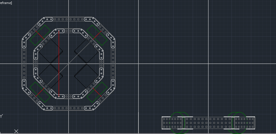

X Drive diagram
If you use a 3.5" long piece for the corner segments, you will end up with a close approximation of a multiple of 0.5" for the width (The line drawn across the middle of the base has a length of 8.4497"). You also need to ensure that both the inner and outer parts of your base are of the same length.

what softwear do you use to make this image? hope to get an anwser from you lol
AutoCAD. Not Inventor or Fusion, the og. You can do this in both of those though too through sketches.
thanks! I’m an Inventor user,seems like I should get an auto cad now
It’s good for first drafts imo. It’s available for free with a student license

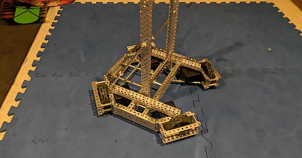

I spent some time this year designing an x-drive in Fusion 360 to make sure everything lines up perfectly, and I’m pretty happy with the result. It is quite strong, and a change up ball fits in between the motors in the front. Here are some pictures of my design
This is actually really nice. Love the use of standoffs to make braces to maintain the frames stiffness. I assume you used the shaft collars to make the right angles there? Did you tap them to be 8-32 as opposed to 6-32?
Just wondering, is there a reasoning behind not having like an c-channel on the outer sides of the bot?
