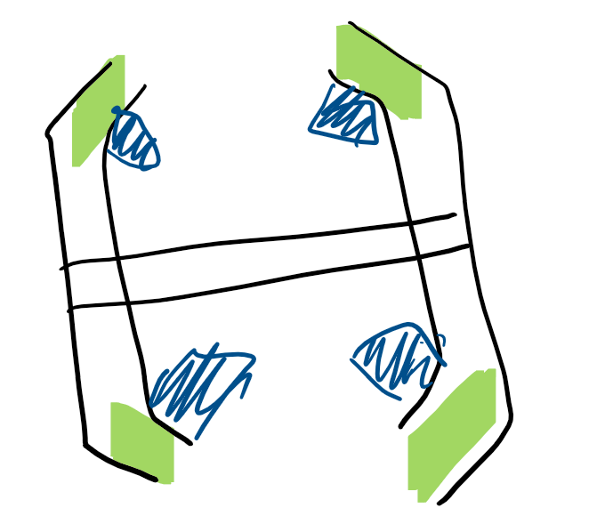

I had a few questions about the wheel assembly in X-Drives (and any drives for that matter).
In an X-Drive do you need shaft collars either side of the wheel? Or on the end of the shaft protruding from the c-channel? And in terms of washers and spacers how many do you need? Where should you place them? And how big should they be?

Not really; you only need enough shaft collars to hold the shaft in place (generally one). However, I usually like to use two per shaft in case one fails.
A shaft collar here doesn’t really do anything.
They should fill the space between either c-channel.
Really all of these are not specific to x-drive, but are true for any vex drive.

Just to clarify - for shaft collars where would you position them?
Anywhere that stops the shaft from falling out…? That’s what shaft collars are for :slight_smile:
Ok - So for example on the inside edge of a c-channel where the shaft goes through? - Presumably you’d need a washer between the collar and the c-channel
Yes.
No, just give it a bit of wiggle room so there’s no friction.
Sorry for the extreme amount of questions but when you said you’d put 2 washers to be safe in case one failed where would you put the second one?
*shaft collars
between the channels or between the inner channel and the motor.
yep
