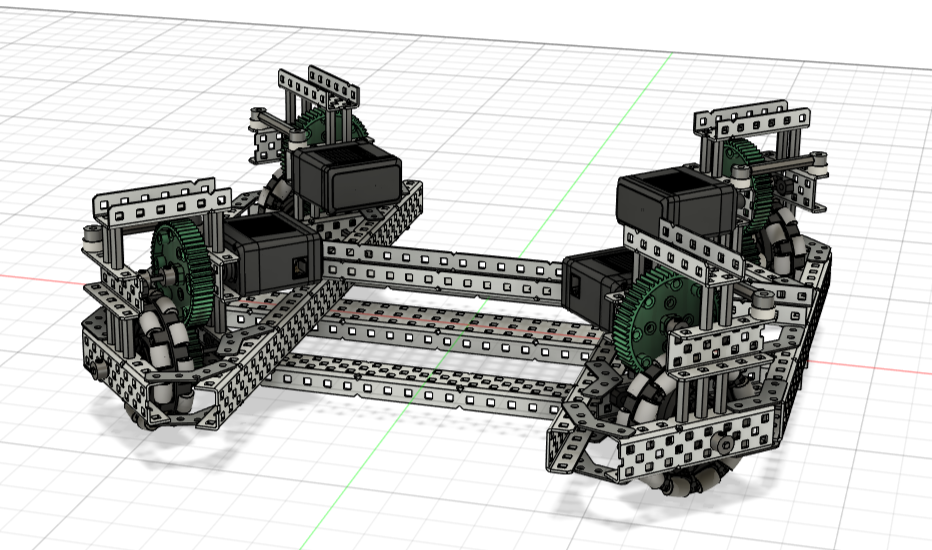

I built a 5:3 (333rpm) geared x-drive for Spin Up and it’s working great so far. Haven’t finished the bot yet so I don’t know if it’s too fast/doesn’t have enough torque, but I think it’ll be great as long as the motors don’t get hot.
Here’s a screenshot of the CAD
The gears, structure, and motors take up a fair bit of space but my team has been able to build around it.
