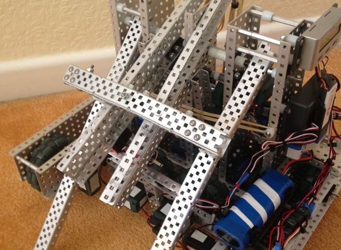

Robot Specs:
• 6 Motor Turbo H-Drive with 4" wheels
• 6 Motor duel puncher catapult
• Anti tip pegs
• 3 Star/1 cube spatula Intake (Not yet complete)
Our launcher consists of a 2 motor puncher and a 4 motor puncher each of which hits a single catapult arm. 3 distances can be gained by using either puncher individually or both together. Having several distances is useful for when we throw different numbers of stars from different places on the field. The launcher is able to:
• Low power puncher only
o 1 star - 11 feet with 5 feet height
o 2 star - 8 feet with 4 feet height
o 3 stars - (not tested)
• Medium power puncher only
o 1 star - 15 feet with 5 feet height
o 2 stars - 11 feet with 5 feet height
o 3 stars - 8 feet with 4 feet height
• Both punchers together
o 1 star - (too far to do indoors)
o 2 stars - (never tested but will be too far to ever be needed)
o 3 stars - (11 feet with 4.5 feet height)
All tests were carried out using Skyrise cubes as we have not yet purchased the new elements. Half a Skyrise cube is about the same weight as one star (half a cube is 210g and a star is 270g ) so we used between 0.5 and 1.5 Skyrise cubes for our tests. Once we get some of the game elements it wont take long to adjust the bands on the launcher to fire similar distances for stars. We found heights be throwing over boxes stacked on top of each other.
We will be revealing the mechanism used for the punchers in future videos in the next few weeks. Currently it has about a 1.5s recovery time but we will try to improve that.

We are using limit switches to tell the launcher mech to stop. The launcher mech we are using has a built in hang lock and the 6 motors from the launcher combined can lift the whole robot in about 3s but we have not yet made a hanging hook so we are far from being able to properly test hanging but we will be aiming to high hang.

How does the launcher stay so low to the ground and still allow you to drive around?
Yes the half cube is about 210g whilst a star is about 270g. Our launcher is not anywhere near overheating so the difference in weight will easily be compensated with bands without causing any problems
The robot is within the size limit apart from the spatula which we are currently building locks for so it can extend and start in the size limit. We will reveal the spatula when it is finished
Our actual spatula we are working on is made with acetal and so has low friction with the ground. Some teams used spatulas in early season sack attack so im sure there will be videos of robots which have used them on vex tiles.

Is “wallbots are dead” a really high arc, or a high-energy flat trajectory meant to break a wall? Also, what made you guys decide to use an H-drive?
High arc. We saw that there was a need for a holonomic drive in this game - to provide greater manoeuvrability and so a faster scoring rate. We chose a H-drive over and X-drive due to the shape and space issues with an x drive, along with the distribution in power of the drive.
Wow, that was quick. It looks like an extremely capable robot as well. If I understand it correctly, the two punchers hit the catapult arm either together or individually?
Yup. This allows us to have three different ranges on the field.
