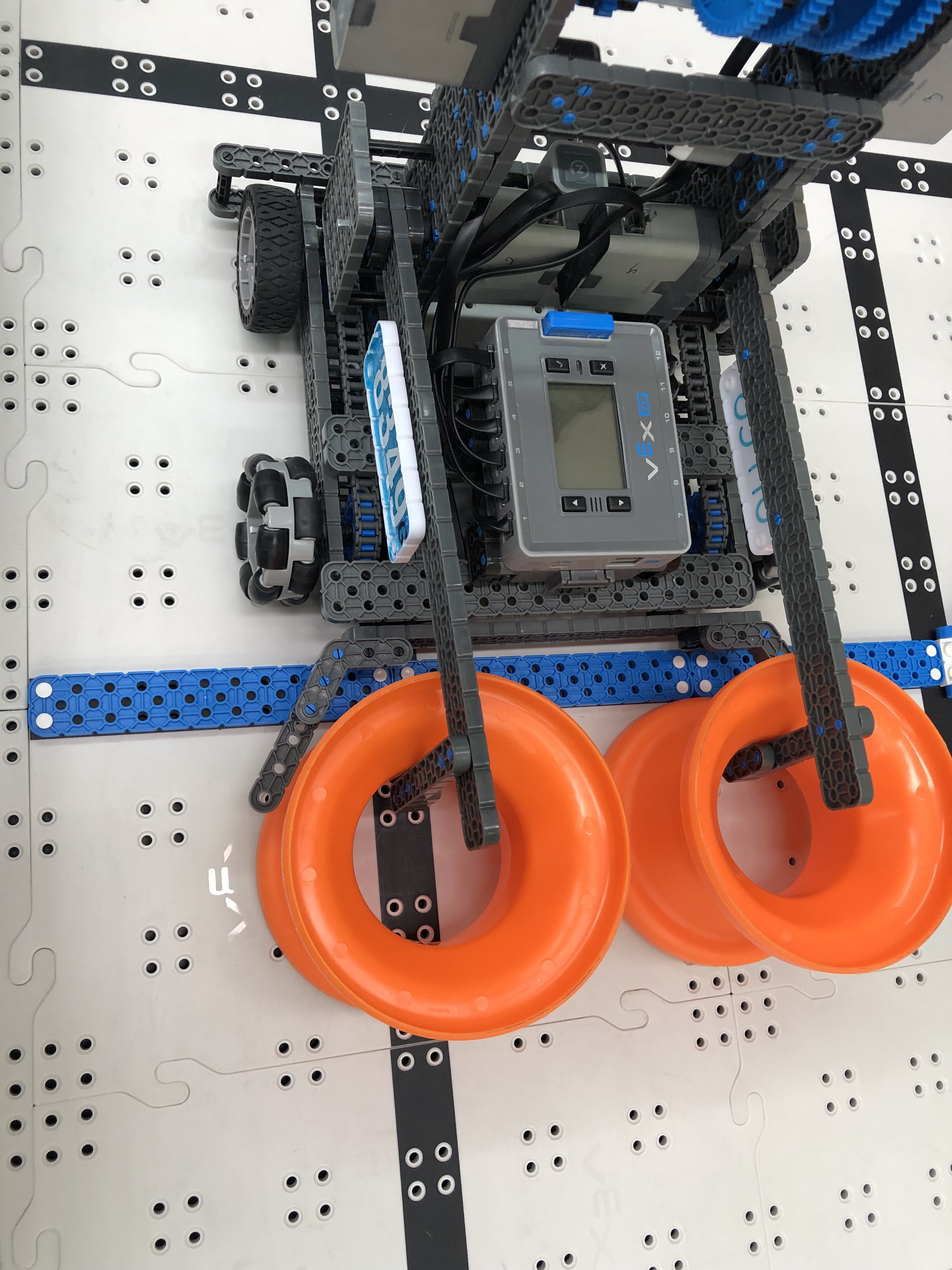

What could be done for the kids to get a higher score? The are using a mantis style that can pull two hubs.

That’s a pretty decent score. Are you using the side by side stingers each on a motor? We have teams that are in the 16-17 range with a single stinger. They were spending too much time messing around trying to get the second hub on the stinger.

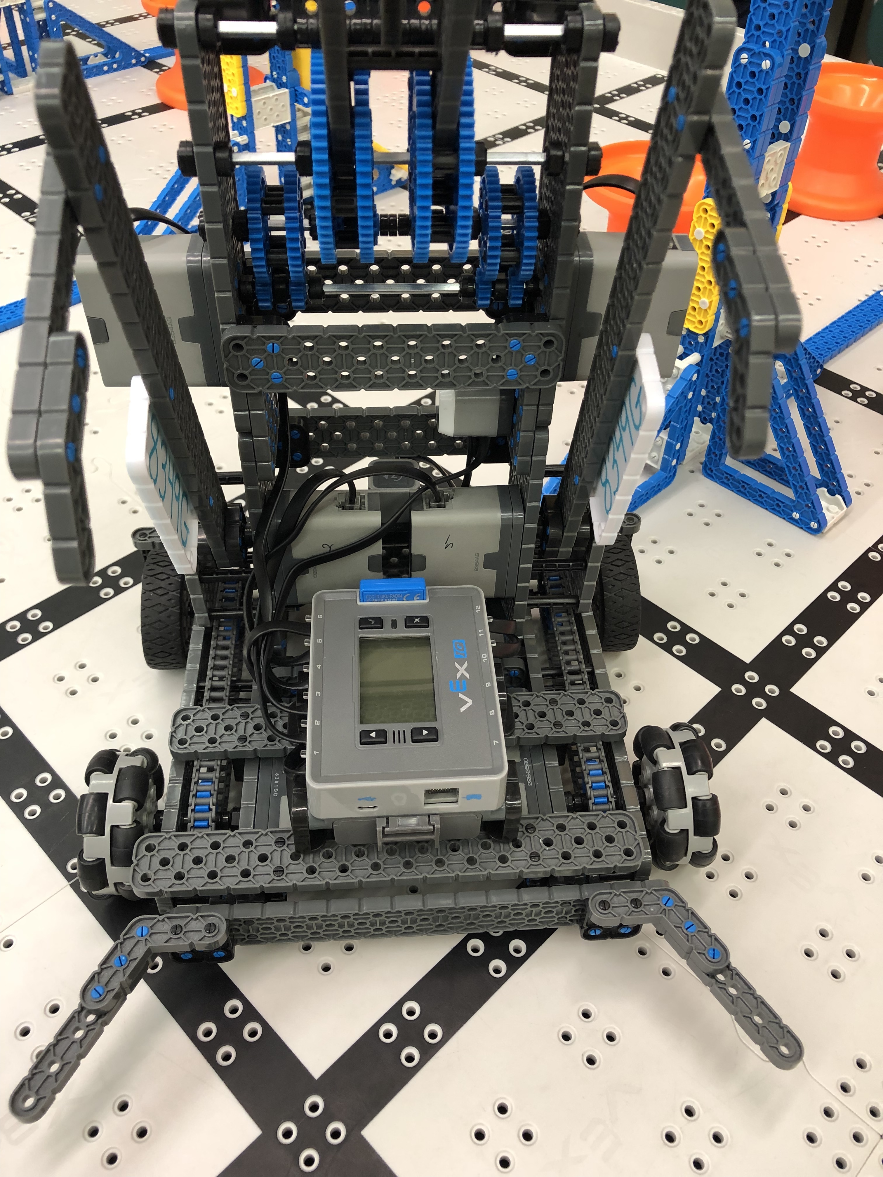

image image @Foster They are using 2 stingers on independent motors, but are programmed on one button for up and another for down. The thing that helps them is the guides they installed on the front to funnel hubs and then they just put the arms down to hook them. They score 19pts in 45 Sec. Arm is a 4 bar with a 15 to 1 ratio.
