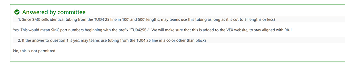

Wait, you can only use black tubing? I can’t find this in the game manual.
Silly, I know:
https://www.robotevents.com/VRC/2021-2022/QA/883
