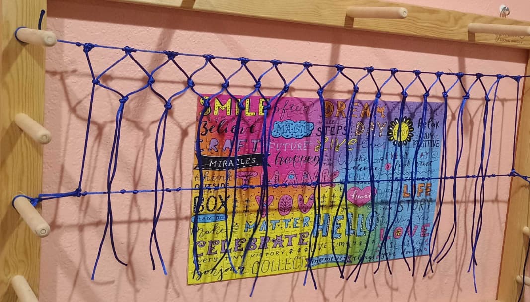

How’d you make your nets?
Basically we used satin cord. we kinda made a rectangle with it, the top string had knots measured out so that there were holding each piece of string keeping them from shifting. We used lark’s head knots to attach the string to the top string. Then take two ends which weren’t attached to each other and used more lark’s head knots to tie them together, making a diamond shape, until we reached the bottom string in and tied them off.
Some videos might be able to help you visualize it, In addition here’s a photo of me making the netting. We used a warping frame to keep the tension even, since strings have a tendency of expanding with force.
