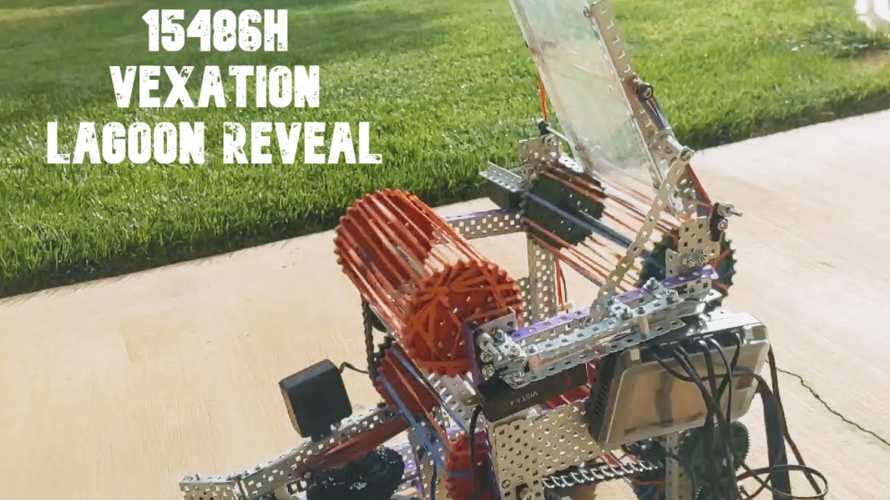

Hey guys, this is (maybe) the final iteration of our robot for Change Up. Sorry about the camera work, lack of scoring shots, inconsistent robot design, etc. as we didn’t have time to film, so enjoy!
4M: 200 RPM X-drive
2M: 200 RPM Intakes (300 front)
1M: 333 RPM Bottom Roller, 832.5 RPM Top Roller, 370 Back Roller
1M: 600 RPM Sorter
PS. It can cycle way faster than in the video
