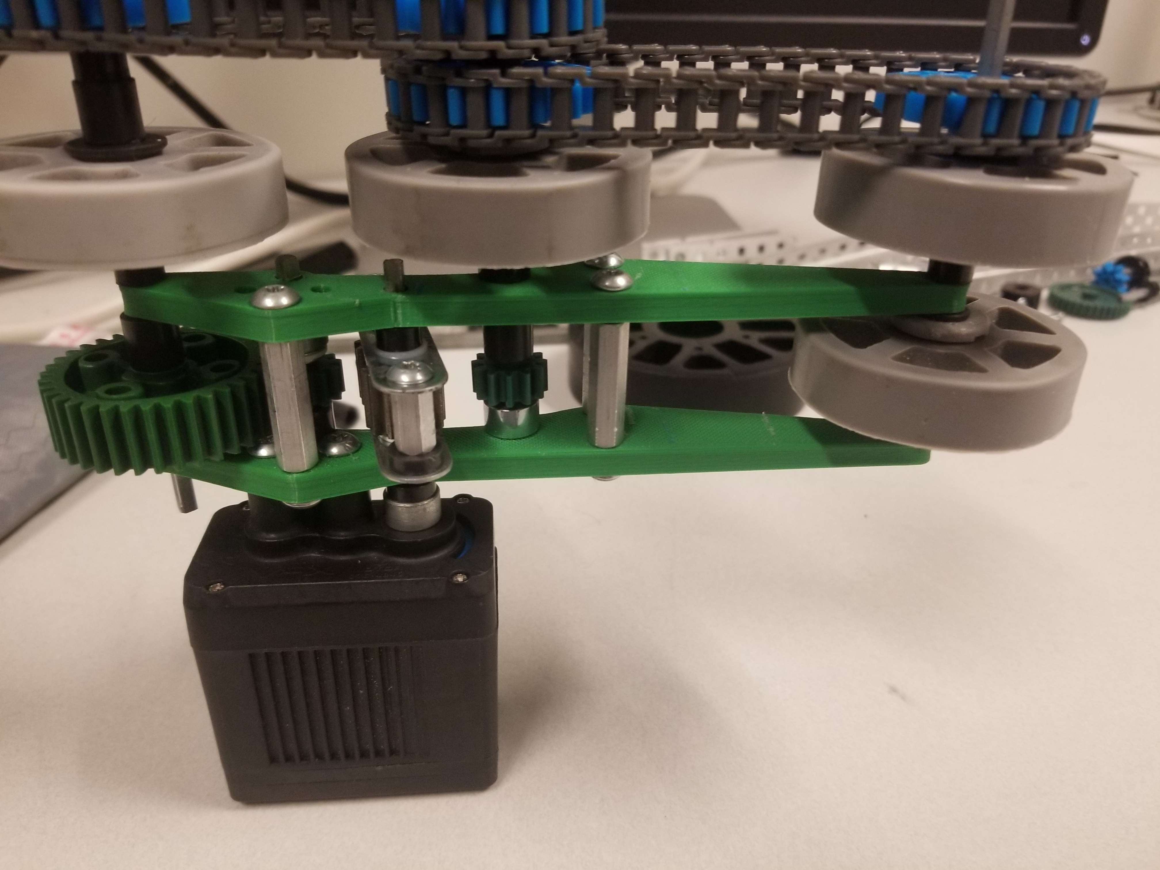

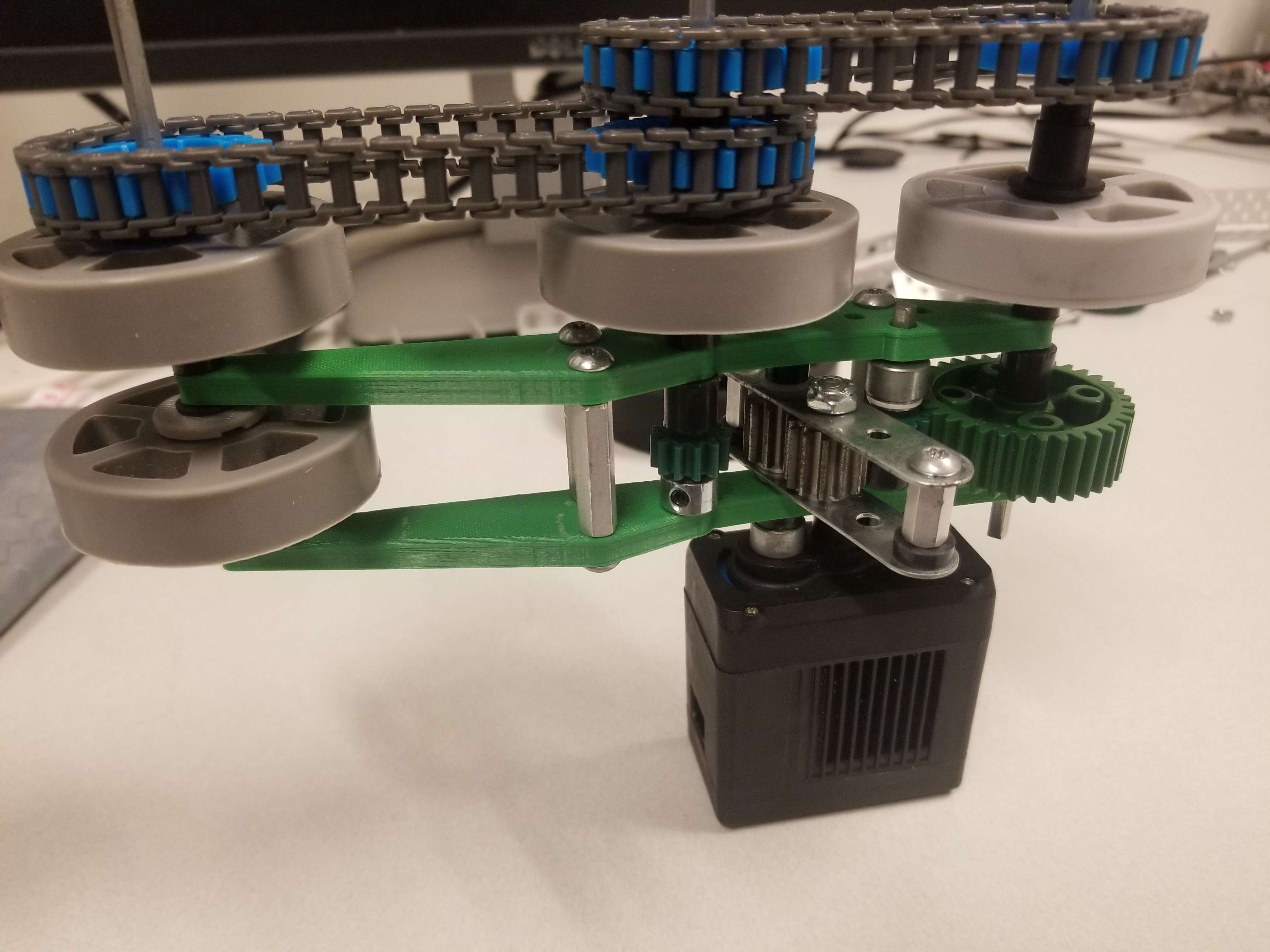

I think it is an interesting idea attempting to use a single mechanism for multiple purposes, and as I understand it, this post isn’t really about the design of the overall robot more of just, is there a way to get two different output forces using a single motor, and the answer is “yes, kinda”
One way to do it is to have the motor spin one direction and control one gear set and spinning the other direction mesh with a different gear set.
So as you can kind of see in this image, the motor is connected to a gear and another gear is connected to that one in a method not unlike planetary gears. As the motor spins one direction, the gear will move into mesh with the other gears and spin them one direction, but when the motor is reversed, it comes into contact with a different gear ratio for the same system.
Something of note to remember is that you cannot get 4 outputs with a binary input. So you would not be able to go up and down with 2 different gear ratios, but if you have something passive such as rubberbands pulling in one direction, when your motor is not applying a force to either side, the entire system can default to up or default to down so that it is still usable.
Technically this could still work moving up quickly and lowering the arm slowly, but if you want a fast up and down movement you might get a little fancy with rubber bands.
I hope I explained that well, our team has used them a couple times, but has not been able to find them in use in other places. So if you have any questions or found this useful, (or not useful but interesting) lmk if you need more information.
