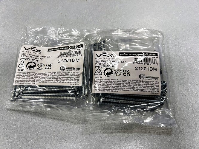

I currently use the colored robosource torx screws, and after experiencing how much better torx screws are than hex I never want to go back. However, I have not been able to find 2.5" long torx screws with the right thread size anywhere. The closest thing were these hex screws from McMaster-Carr. These would work, but like I said, I’d prefer to not have to use hex for anything.
So my question is, has anyone else been able to find 2.5" T15 8-32 Screws anywhere?
and if not, is it a safe bet that robosource will be selling some in the near future, or should I just suck it up and buy the hex screws?
Kevin (from Robosource) talked a little on VTOW and said he is working to stock the new screw lengths, so our team will most likely be waiting on that.

We will be selling up to 2.5" screws. I’m sure there will be a new products post when they are available.
@Sidoti, and Kevin from Robosource (I don’t know if he has an @ on the forum), is there any progress on this? 2.5" Screws would be very helpful…
And @u89djt, how did those screws work out? Did you order them?
I ended up needing quite a few 2.5" screws for my robot (they work perfectly for a screw joint on a 6 hole wide drive side.) so I went ahead and ordered the hex screws from McMaster that I linked in the original post.
They suck because they’re hex head, but they work. Just be careful not to strip them because I speak from experience when I say removing a nylock off a 2.5" stripped hex screw is about as terrible as you can imagine it is.
I did but they haven’t seen action further than checking geometry and a couple of experimental assemblies, so I can’t comment on material quality. Robosource are probably having enough trouble with their existing portfolio with container shipping as it is these days.
