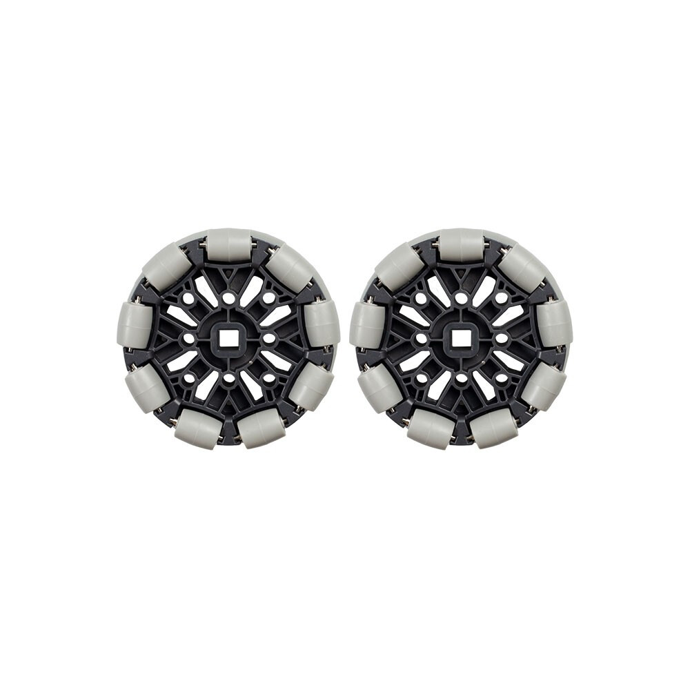

2.75" vs 3.25" | Torque, Acceleration, and Force Comparison Question
From my understanding, the 2.75" Omni-Wheel (compared to the 3.25") has Better Acceleration but a Lower Top Speed (on a drivetrain). Possibly, the 2.75" also has More Pushing Power (this could be due to either Torque or Force—I’m not sure).
Does the 2.75" have Better Pushing Power on a Drivetrain compared to the 3.25"?
Please correct me if I am wrong.
