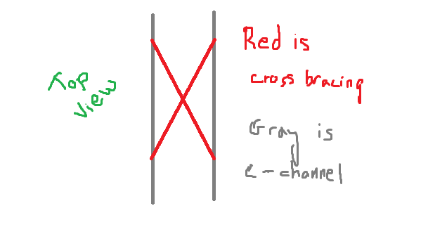

Use either multiple horizontal braces or use cross braces. Cross bracing is better and you generally use less material, standoffs rather than c-channel, so I would recommend trying that. Remember to brace both “halves” of the dr4b as well.

We have 3 horizontal braces across the bottom half. There are only vertical braces on the top half since the top half is 1 piece.

Cross-bracing is connecting the lift across the 2 sides of the lift. A diagonal member if that’s not clear.
Screenshot_33
Sorry for the bad writing, I can’t use ms paint for the life of me lol.
I am aware of what cross-bracing is. We are not having any stability issues with the lift, so we didn’t feel the need of switching to it.
Yes but you have much unnecessary weight as a result of excessive bracing. Since your motors are dying, from looking at your lift, the most likely problem is they are malfunctioning due to the sheer amount of weight they are attempting to lift. By removing the vertical bracing on the sides of your lift and using just some cross-bracing, not only will you decrease weight, but it will allow you to increase the tension in the bands as they currently have little impact as they are not really stretched out to their full capacities.
The lift really doesn’t weight that much, especially since the tension of the rubber bands holds it completely. Two 100 RPM motors geared 7:1 should not struggle to lift it, especially when there are no cubes. It also did not struggle to lift our past 2 competitions. This is a very recent issue.
