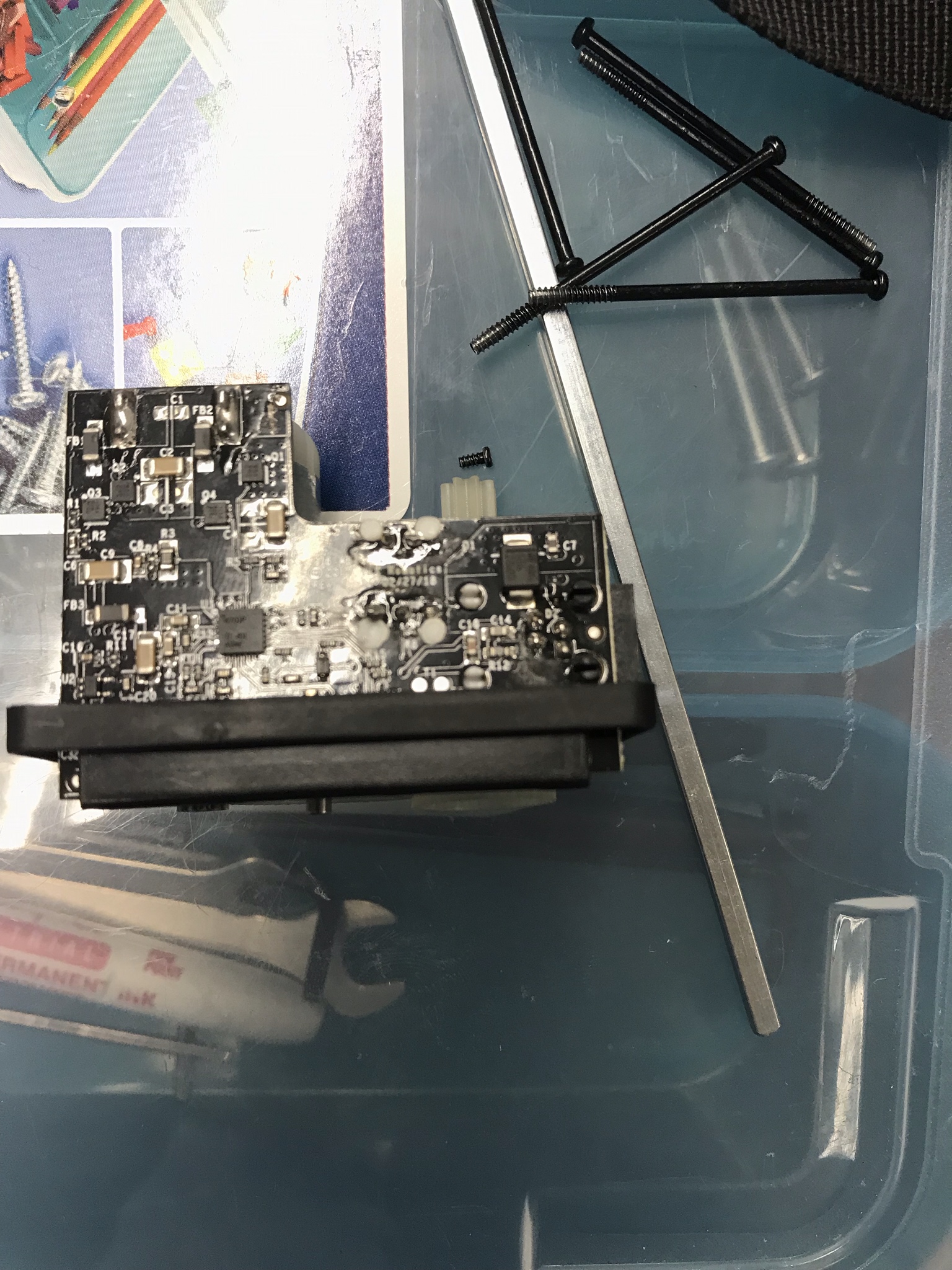

We took apart the motor to inspect the circuit board, and found damage looking down and to the right of C14 and R12 (away from the motor). Our theory as the damage here caused electricity to turn into heat, overheating the motors. I have a picture of this damage in case anyone wants it posted, but it’s blurry due to light reflection.

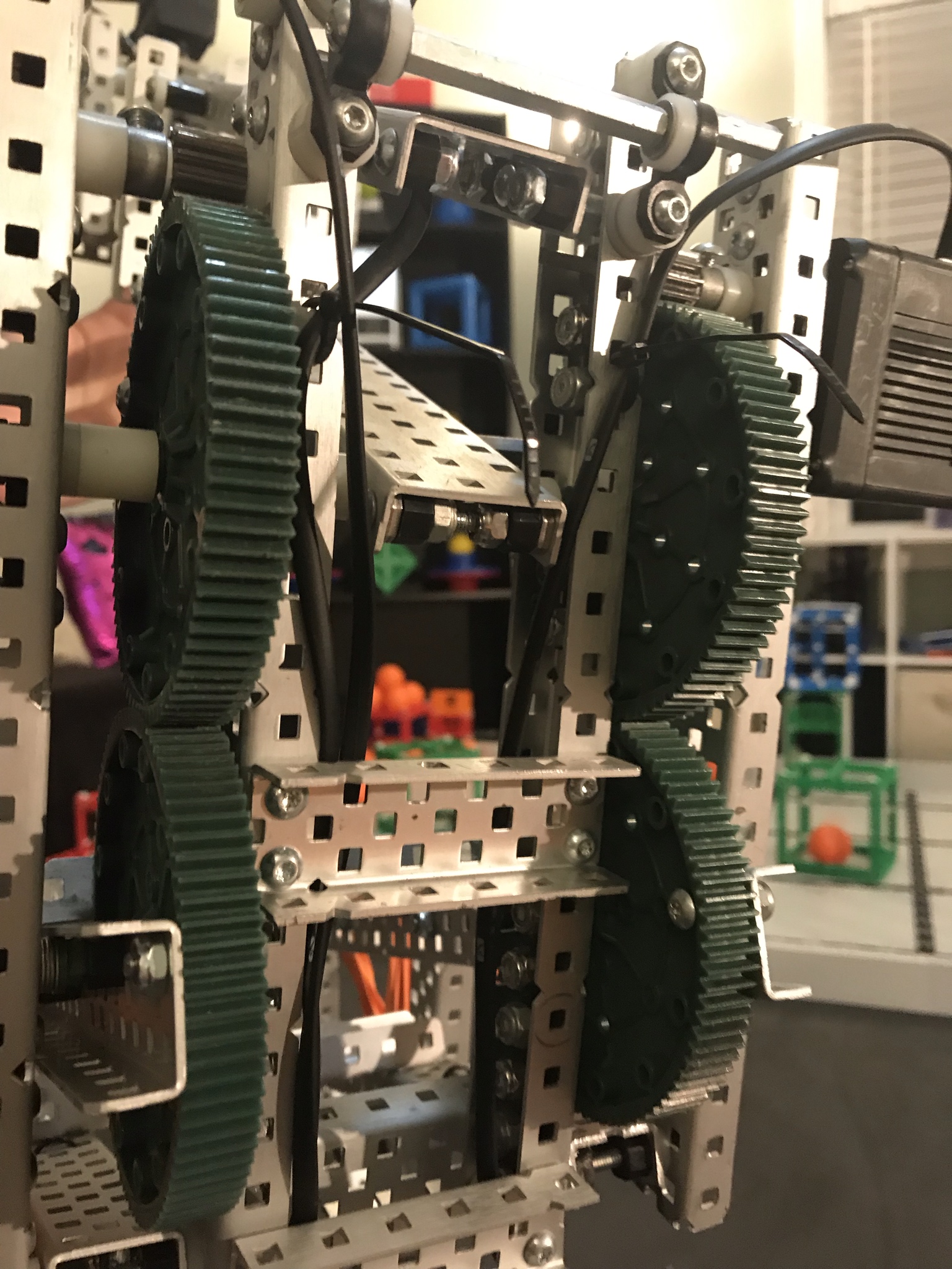

Do you have any pictures of the lift? I’m no electrical engineer or anything but if multiple motors and a new brain were tested, it might be the lift. Does it have rubber bands on it?
They do have rubber bands on them. I have some images of the lift, if you need better images/images of different parts or angles, let me know and I can get them tomorrow.

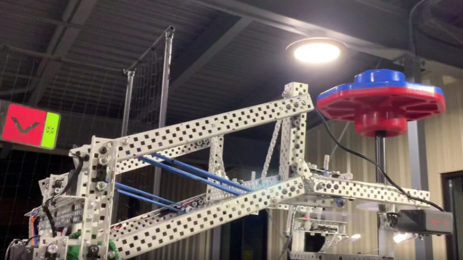

Just a few tips for the lift:
  1. Those small C-channels you have running between the lifting arms are really unnecessary. All they do is add more weight, add more friction, and prevents you from mounting rubber bands in better positions.
  2. Speaking of rubber bands, I would highly suggest changing to a single triangle or 2 point rubber band set up on each set of lifting arms. Having your bands stretch longer allows them to use their potential tension much more effectively and if the bands run too short you risk not gaining any extra force from them at all.
Example
This is from our TP worlds robot. By no means is this the end all be all way to rubber band, but it is certainly a fine example to use for a solid lift design.

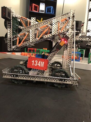

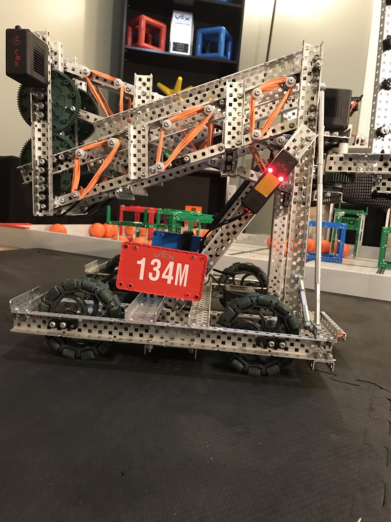

  1. That C-channel mounted on top of your lifting bars seems really unnecessary and does not seem to serve a purpose
The C-Channel running between bars are supports. They significantly reduced how much the lift swayed. They are generally unnecessary on smaller dr4b’s, but this dr4b uses 35 hole C-Channel, so supports are necessary. I will look into ways we can move them around a bit, but I believe removing them completely will end poorly.
I agree that the rubber band placements are not ideal. I will definitely try changing that up.
The C-Channel running across the length of the bottom half is another support. This one helps prevent the bar it is connected to from twisting. We’ve experimented with the placement/removal of the bar, and noticed that it also helps decrease sway in the lift.
Weight shouldn’t be the issue we’re having. 2 V5 motors with 100 RPM Cartridges and geared 7:1 should more than be able to handle its current weight, especially since the rubber bands hold it up.
do you have any videos of the lift raising and lowering? There doesn’t seem to be any huge problems besides the banding (which is a small issue i think).

Yea, send me the picture.
Are the motors still functional ?
Here is the image:
Sorry for how blurry it was, the reflection of the board made getting a good image difficulty. I can try again tomorrow if this image isn’t good enough.
The damage is down and to the right of C14 and R12 (the gray area).
We came to the conclusion that the motor was overheating due to it getting hot, and lowering the max output of the motor in the same fashion a normal motor overheating did. The motor is still functional, but cannot be used much before it gets hot. We opened up the motor 45 minutes after shutting off the robot, and the circuit board was still radiating heat.
I don’t see anything unusual around C14 and R12, that’s just normal flux residue.
So from completely cold, how long before the motor overheats ? Once the motor gets that hot, it’s quite normal for it to take 30-40 minutes to cool down again (back to ambient temperature)
It took between 60 and 90 seconds before performance was impacted, and another 30 seconds before the lift no longer moved.
