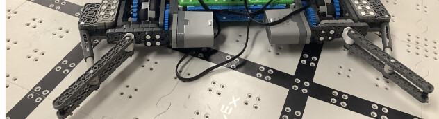

  1. The line-up: It helps your robot line up with the goal in driver control and autonomous. Pictures below: :point_down:

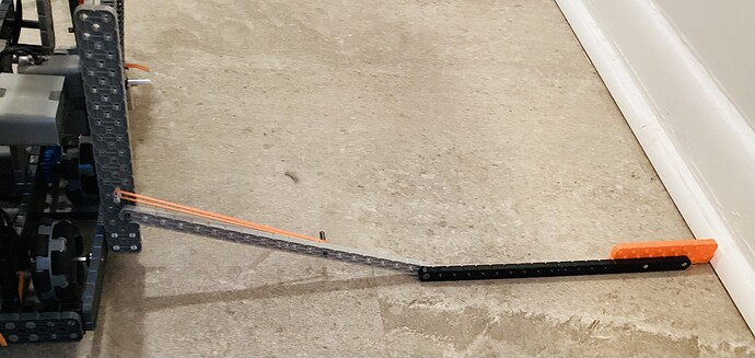

  1. The head-start: It gives your robot a “boost” off the side wall at the beginning of the match. It is completely legal and will retract once your robot moves, as to allow for more movement across the field. (Use 32x synthetic rubber bands) Pictures below: :point_down:

Do you think it would be better to use a flexible auto aligner or a fixed one? My teams current bot uses a flexible one, but we are wondering if it would be better to use a fixed auto allighner.
I think a flexible one would b good, we don’t have the prices for a flexible so we used a fixed one :slightly_smiling_face:
I think that a flexible auto aligner would be better, but if your’s keeps breaking off of the robot, you might want to switch. If it doesn’t break, I recommend keeping it flexible.
It does not break, but it does not work the best either. This is because when the robot comes in at an angle more than 30 degrees, the suspension beam (I think that’s what it’s called) bends too much, making the robot not able to align to the goal right.
The flexible aliner is stronger. The fixed one always breaks off and in teamwork/skills that may be a huge problem

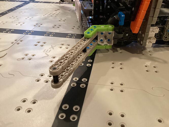

Can someone post a picture of the flexible one as some of us don’t know it. Thanks!
Basically, you need to use an suspension beam to connect the robot and the piece of alignment. This is our old one:
Our new one is a bit longer, with harder suspension beams, which we found aligned better.
