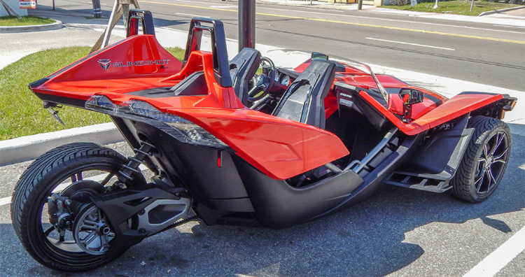

3 wheeled drive. (Or in this case, 3 motored).
(Not mine, I just found it online):wink:
Front 2 wheels are main power, and make it turn.
Also the back wheel would have to be an Omni wheel.
Probably not very viable, but it would work if you just had to have access to an extra motor. I think it’s also known as an a-drive.
