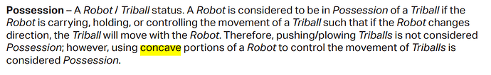

It looks like in the rules a ‘concave’ portion to control the robot is considered in possession, so I wonder what a V shaped scoop, or flat with some edges would be viewed as?

If the triball will change direction when the robot changes direction, it is possession.
