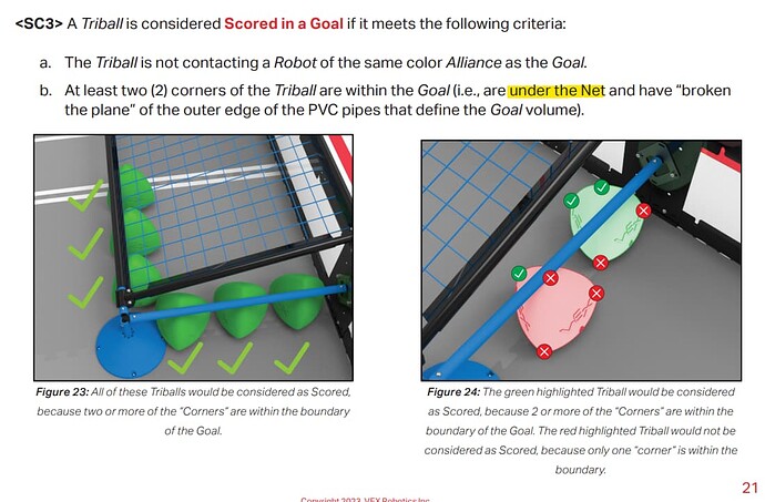

But since the definition of Goal (in the manual) is the 3D vertical projection (see Fig 16 in manual), then shouldn’t placing the triball on top of the net counted as scored as well?
The vertical projection is bounded by the surface of the net
In the same sentance you highlighted, it says the vertical projection is bounded by the pvc pipes, not the net. Being under the net is just a condition each tri-ball has to meet in order to be scored.
Yeah, that diagram is not great. Also note that only 2 vertices of the triball need to be inside the vertical plane, so there is a whole outer row around the goal that can be largely outside it, but still scored (and protected by rule). As soon as you push the object up to the goal bar such that two lower points are inside the goal, it is scored.

It looks like a rectangular block to me - with the height bounded by the highest point of the net.
It makes a big difference whether the goal is defined as a rectangular goal (as shown in diagram) or bounded by the surface (which is sloped).
If it is the latter, then yes, technically we can only score under the net.
But if it is the former, then we can score over the net (maybe that’s why it is called Over Under? ) and the volume of the goal is effectively x2.

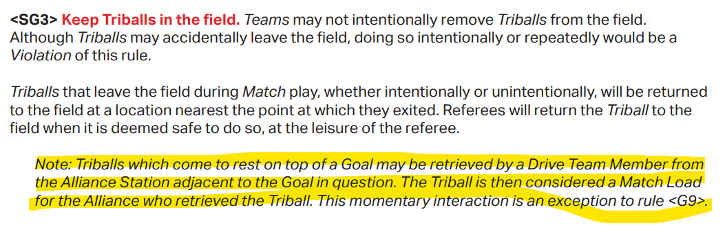

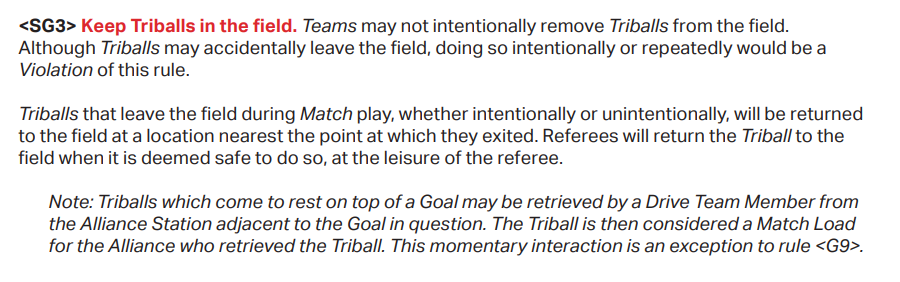

Note: Triballs which come to rest on top of a Goal may be retrieved by a Drive Team Member from
the Alliance Station adjacent to the Goal in question. The Triball is then considered a Match Load
for the Alliance who retrieved the Triball. This momentary interaction is an exception to rule .
In rule as shown above, it is stated that triballs that come to a rest on top of the goal are basically no longer in play and can be used as match loads for the team closest to the goal. Anywhere under the net is deemed a goal (pretty sure, I’ve read the game manual 3 times since yesterday).
Right, which is why it is not a good diagram. As @Mentor_355U highlights in the manual pic, must also be under the net.

I’m pretty sure that it means that they have to be under the net.

There would seem to be an edge case where you put the triball into the triangular area over the horizontal goal bar and under the sloped net bar such that two points of the ball are inside the plane of the goal and under the net == score.

Indeed, triballs that come to rest on the net become available to the opposing alliance as “Match Loads”
So, yes, you can ONLY score under the net.
