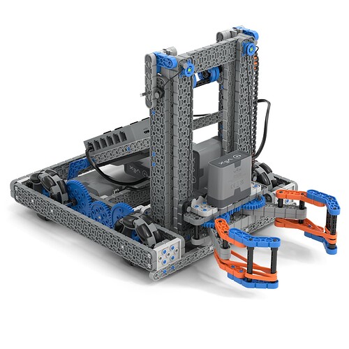

VEX is proud to release the Build Instructions for the 2025-2026 VEX IQ Robotics Competition Hero Bot, Huey, designed to play the 2025-2026 VEX IQ Robotics Competition Game, Mix & Match.
Build Instructions can be found at builds.vex.com

Well, if you still haven’t upgraded your gen 1 kit, now is the time! It looks like you would need to buy the following kits, and the corner connectors on the bottom of the bot are not available for purchase outside of the upgrade kits.
Motor Shaft Add-On Pack 228-7456 $12.39
Linear Motion Pack 228-7887 $10.89
Winch and Rope Pack 228-7884 $15.99
Chain & Sprocket Kit (Blue) 228-2534 $29.99
VEX IQ 1x Beam Pack 228-9059 $15.49
Hybrid Gear Pack 228-7886 $10.89
24 & 48 Tooth Gear Pack (Blue) 228-4127 $6.99
Order Total $102.63
Not available on the VEX Website:
2x Wide, 30 Degree Right 1x2 Corner Connector (228-2500-371)
2x Wide, 30 Degree Left 1x2 Corner Connector (228-2500-372)
I’m sure someone can post a kit they are in… But… Just upgrade!!!

Anywho, I really commend the GDC for finally making a bot that actually looks quite nice! They have finally used a 1:2 drivetrain instead of the old 1:1, and they used the Double 2x Wide, 2x2 Double Offset Corner Connectors that have been used heavily for drivetrain spacing in many competitive robots over the past years. The cascade lift is a nice touch as well!
These have been is some games. In looking at the build, they are used as a brace across the bottom of the robot. So it will be pretty easy to build this without this part.

Does Huey have a VEX Robotics Part Number? i.e. like 228-3428-750 for Gen 1 Clawbot, or 228-8899 for Gen 2 Basebot
Reason for asking - to keep all my CAD model in some kind of alignment with the VEX “system”
Here’s a parts list we threw together in case it’s helpful to folks (we have kids make kits to take home over the summer)
Huey Parts List
omg YOU are amazing!!! I was about to spend 2 hours scrolling the 3D visuals to pull all the parts. Not all heroes wear capes
I’m very proud of the GDC for this herobot. This does everything a herobot should. Introduces mutliple good build practices, build quality basics, and plays the game well but not insanely well. Props to them :clap:
