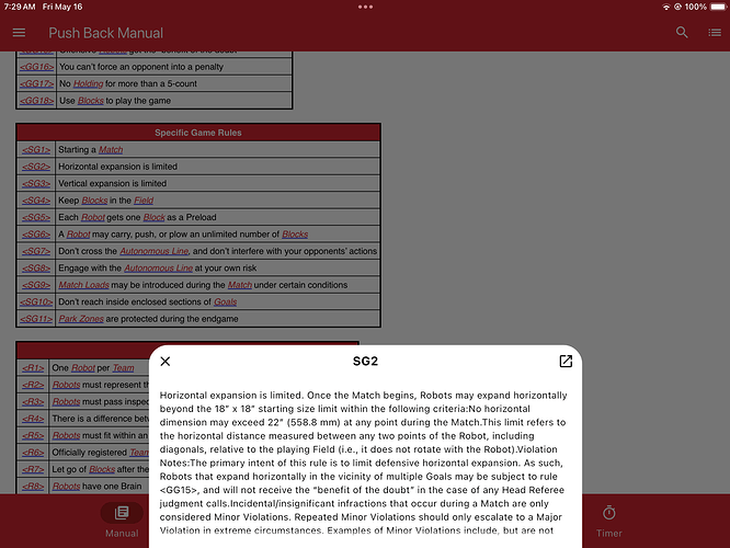

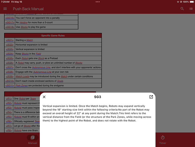

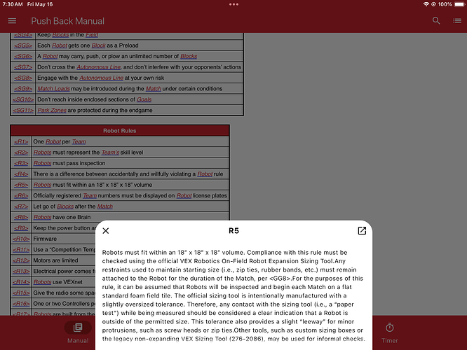

What is the size limits of the VRC robot. This manual only references VexU and their robots are typically larger than VRC.
The game manual does state the size limit for robots in V5RC, take a look at R5
The vex u symbol by the rule means this rule is DIFFERENT for vex u, and to read the vex u section for the change. The rule I think you read does not apply to vex u, it applies to v5rc
I assume you are referring to the size rules with the VEXU sign; those are normal VRC rules and the VEXU symbol means that they apply differently to VEXU. The VRC robot size limit is still (sadly) 22’ diagonal.
