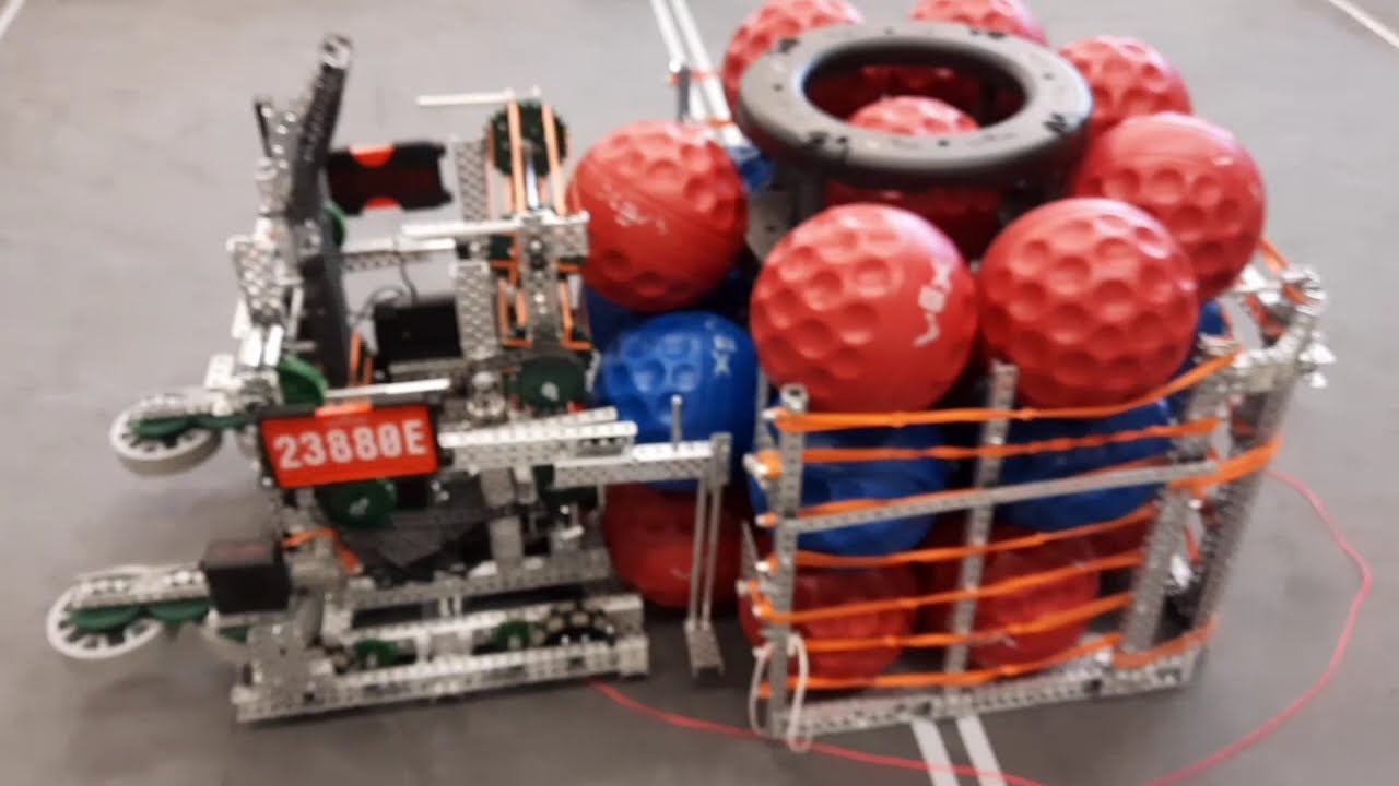

This video is a compilation of highlights from this past season, Including our cage bot build for worlds.
Enjoy, and good luck next year in Tipping Point!
State/Skills Bot Specs:
4m 200 rpm 3.25" X-Drive
2m 200 rpm Intakes
2m Indexers (600 rpm bottom, 1200 rpm top)
Cage Bot Specs:
4m 360 rpm 3.25" Tank Drive
2m 600 rpm Intakes
1m Indexers (600 rpm bottom, 1200 rpm top)
1m 100 rpm 4-bar Cage Deploy
18 Ball Capacity Cage
