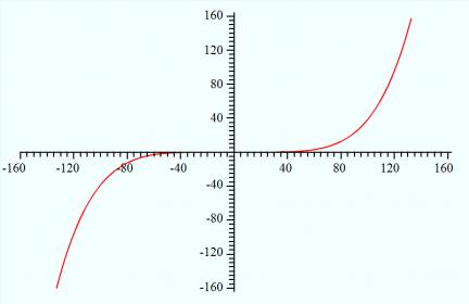

    Q: have you printed a table of -127…127 input values to output values?
    Note that over half the joystick range (-65…65) has |strength| < |20|
alt0: try 3rd power of TempScale instead of 5th power and see how it drives.

No, I do not. I had originally just tried a few numbers to see the results I would get, and also entered the equation into a graphing calculator. Here’s what the graph looks like: [ATTACH]4114[/ATTACH]
Did that. Tried from 2nd power all the way up to 6th or 7th, I believe. This one seemed to have the best results, from my testing, though I probably should have retested the different powers later, after some changes were made to our robot.
