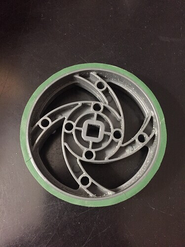

The process I went about making these wheels was initially pretty complex and overengineering, but I’ve refined it to a pretty simple method, where I sanded down the diameter of a 3.25" traction wheel:

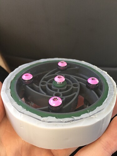

and then I cut the rim of a 3" flex wheel from the spokes, and then cut it down width-wise to be the same width as the 3.25" traction wheel hub.
Then I put two polycarb retaining discs on either side to stop the flex wheel tire from slipping off sideways
so if there is a particular gear ratio or other reason your team has for pursuing 3.25" wheels, using a 6 wheel setup with a custom traction like this in the middle is definitely a viable option.
