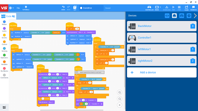

I made a 3 wheeled Omni wheel robot, but am having an issue with programming. The rear motor is slower than the other 2 and I cannot get it to go faster. I have slowed down the other 2 to fix it but would like to make it faster. Is there any way to make the motor full speed? I also am having an issue uploading .v5blocks files here from my Chromebook. Could anyone help me with these issues?

It might be as simple as ensuring all your motor velocities are manually set to 100% at the start of your program. (Edit: it’s a driver control program + kiwi drive I see)
If you’re using V5, you can look in your devices menu and set your motors to spin separate from a program. This might help you isolate the issue if it is a faulty motor.
I am using V5 programmed with blocks

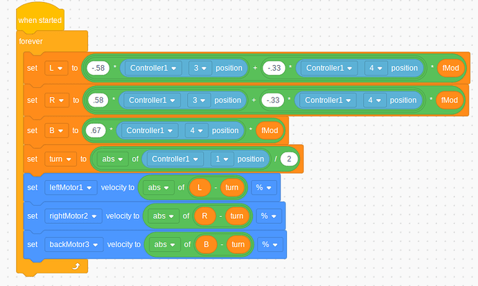

	// calculate variables and increase result by fMod
	fL = (-.58 * vexRT[Ch3]) + (-.33 * vexRT[Ch4]) * fMod; 	// force for left motor based on matrix math video
	fR = (.58 * vexRT[Ch3]) + (-.33 * vexRT[Ch4]) * fMod; 		// force for right
	fB = .67 * vexRT[Ch4] * fMod; 					// force for back
	// turn component of holonomic motion. large dead zone allows use of Ch2 for fly wheel control. halve the signal to turn slowly
	turn = abs(vexRT[Ch1]) >= 60 ? vexRT[Ch1]/2 : 0;
	// motor output in ternary to provide a dead zone on controller (only signals over 15 result in motor value changes)
	motor[driveL] = abs(fL - turn) >= 15 ? fL - turn : 0 ;
	motor[driveR] = abs(fR - turn) >= 15 ? fR - turn : 0 ;
	motor[driveB] = abs(fB - turn) >= 15 ? fB - turn : 0 ;
The first bit shows the proportional signal value for each motor in finding power levels for X and Y vectors. I have multiplied them by fMod = 1.5. The proportions remain the same, but the total power value is increased.
Second bit is the W (turn) vector, which is the same proportion for all 3 wheels. It is written as a ternary and only accepts high turn values and reduces the weight of that signal (holonomic drives turn fast.) In plain language you can read that line as “If the signal from channel 1 is greater than 60, set the value of turn to 1/2 the value of channel one, if it is not set the value of turn to 0.”
The third bit is the motor command to spin the motors. Also a ternary to ignore low values to make a dead zone on the controller.

This is the code I have now. Do you think this will work? I don’t have access to my robot to test right now.
Pretty close, good job interpreting text to blocks. The abs assessments in my code were to filter out low numbers. You need to remove them from your code. Taking the absolute would turn negative signals into positive signals. You might also find that your bot turns opposite of what you expect based on how your motors are oriented. If so change - turn into + turn
edit: and as @technik3k points out, the .58, .33 and .67 are theoretical correct values based on a perfectly balance robot. You may want to adjust those values for each wheel based on observation.

Works now with only a small amount of right turn. This is what my code looks like now.Screenshot 2022-05-04 3.48.09 PM|506x500
