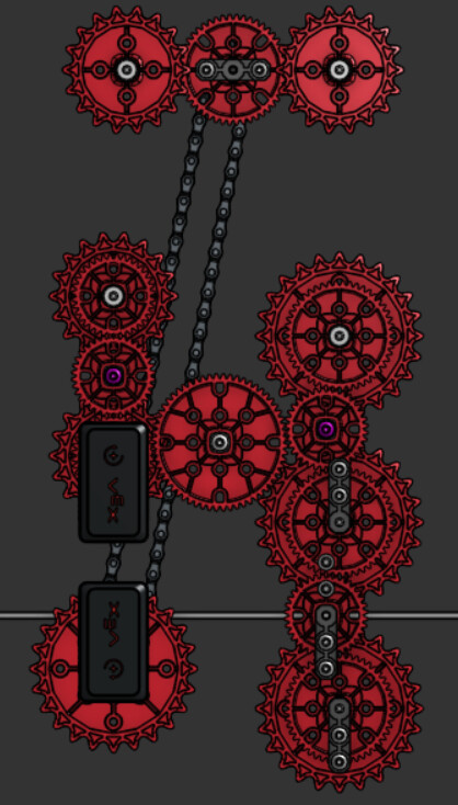

How do you index between long goal scoring and hoarding? There seems to be no pneumatic cylinder that switches between the 2. Are you using the intake motor for this as well?
How much does your robot weigh? How do you split up the 2 11W motors to power the basket intake? Do you use ratchets to accomplish that?
If you look closeley, we have a ratchet on each side of the robot. We use a ratchet system that allows our motor to spin the selector roller in multiple directions, but no matter what direction the selector roller spins, the rest of the scoring system always rotates in the same direction.
We did this because in our testing the very first roller in a basket system needs an enormous amount of torque to score at high speeds, meaning that using 2 5.5 watt motors would have been suboptimal, so we went this route which allowed us to have one 11 watt motors worth of torque on the first roller at all times.
Our robot is 15 pounds. The general consensus from the community is that it is too heavy, but I chose this because last year I had a 13 pound robot that ran the same drivetrain ratio, and It was still nimble with a mobile goal, which weighed 2.2 pounds, which gave me the confidence in choosing such an ambitious speed for this drivetrain.
I already answered the question about ratchets in response to @BananaPi
Nice! I got around this issue by using combining my intake and scoring motors to either intake blocks into the hoarding basket or score blocks.
(don’t pay attention to the shaft. My CAD decided to disintegrate some mates…)
Mine needs to function differently to this because it is front to back instead of front to front like yours.
