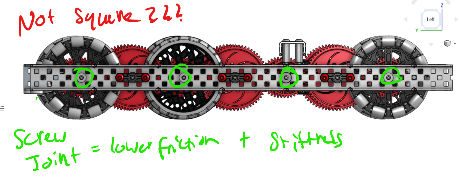

I like the cad and am glad you acknowledged the need for another brace or two!, I also just want to potentially propse to you, how you are going to make sure your drive is squared well, whether that be through structural screwjoints, standoffs, shoulder screws etc!

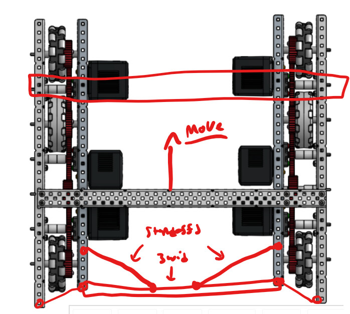

  1. i would move this cross brace forwards and then brace across back with standofs triangle and then 3wide across back verticaly. make sure to triagle brace it as well.

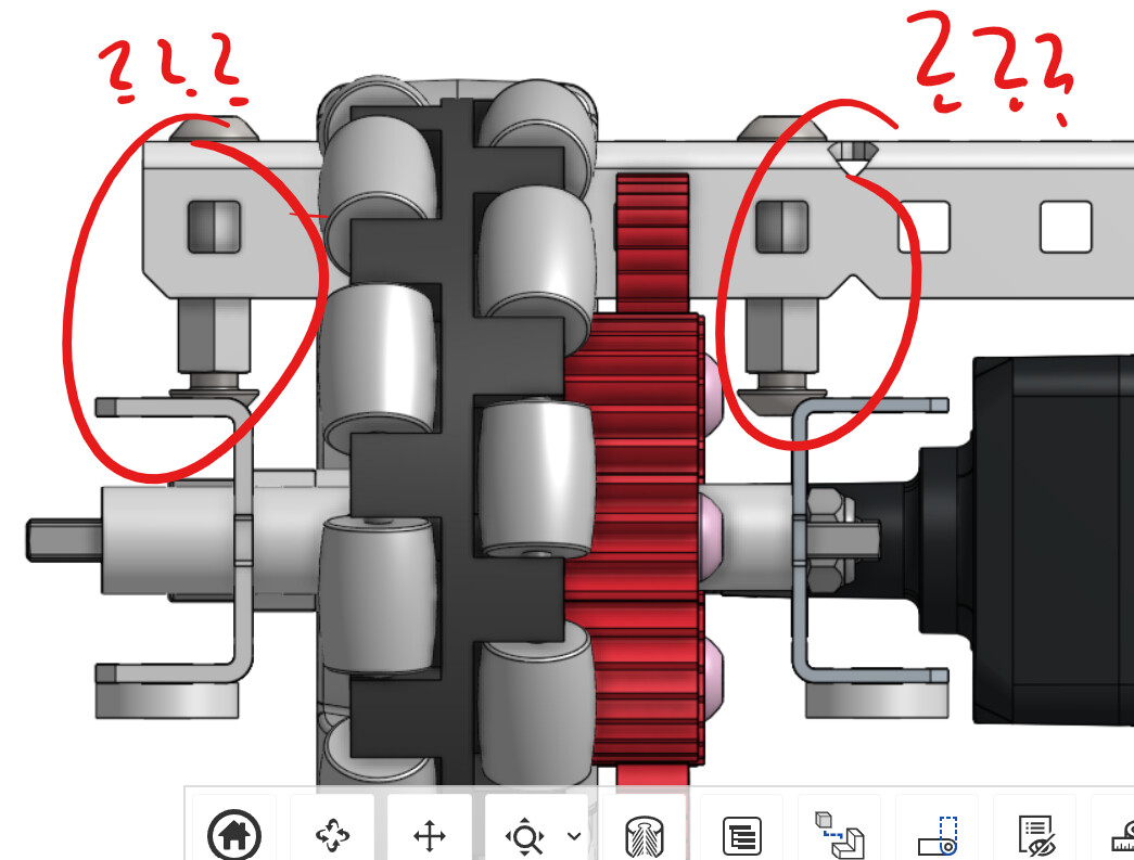

    1. this isnt gonna work im guessing you just screwed up your mates…
  2. change all non motor shafts to structural screw joints will help with friction and stiffness of your drive pod.

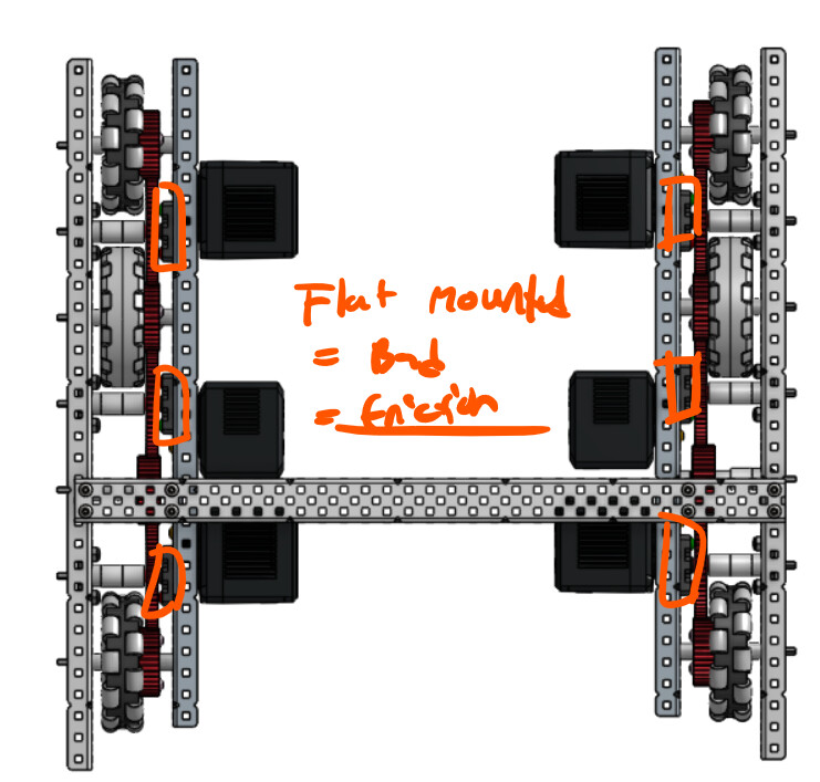

  3. all shafts that have a motor on them dont need a bearing on the motor side. this is called flat mounting. you dont need this bearing because the shaft already alligns to the motor cartrige so its constrained by the motor and if you do have the bearing then you cause mis alignment between the motor and that inside bearing increasing friction. KEEP THE ONES ON THE OUTSIDE only remove the ones on the motor side.

this doesnt show up for me in the design

okay thank you, but how would you triangle brace it

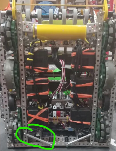

this is from one of my previouse robots.
A few things:
  1. When you have a shaft in a motor, only use one bearing. Any more will add friction.
  2. Use screw joints for gears/wheels that aren’t connected to motors. This will reduce warping over time and reduce friction
  3. Add more bracing. You want at least 1 full cross brace and at least 2 partial braces, as well as bring on the ends of the drive channels.
