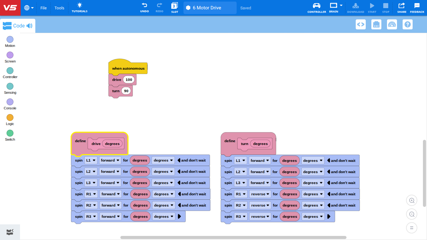

I have a 6 motor drive and I can get the drivetrain to work great but the auton will not work. I am trying to understand what to do because the comp is tomorrow and I need a code. Please let me know what to do to get an auton for my robot.
This is what I have but nothing I have done has worked. I need some help
so what happens ?
how are you starting autonomous ?
where is the drive code ? perhaps thats interfering with the autonomous code .
Nothing happens it just doesn’t move

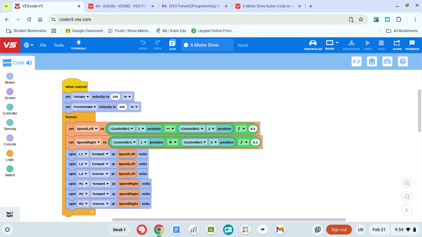

This is the drive code
The code under the when started hat will be running all the time and will conflict with your autonomous code. Put the driver control code under a “when driver control” hat instead of when started.
thank you so much
This works great
