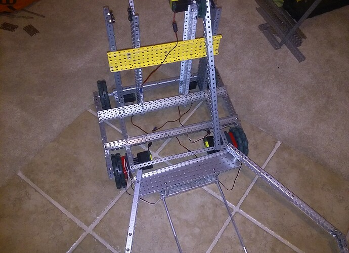

I believe that the lift has high speed motors and not turbo. Also, is there an advantage to only having the middle wheels powered and not the back and front ones. Also, i have seen many teams in my area going with the 3.25" omni wheels instead of the typical 4" omni wheels. I’m really confused becasue for the robot i wanted to make I wanted to use 4" turbos, but alot of the good teams in my area have 3.25" high speed.
4" wheels on turbo motors is running very close to the limit on 4 motors. Smaller wheels give you more torque because per rotation, you travel less distance. A 4 motor turbo drive on 4" would need your bot to be lighter than 10lbs at most.
Responded, good luck with the school project
^^^^^ yep. It also has a built in bias to be more likely to tip back because most the time its against the fence and doesn’t matter and it can self right.
The robot is about 8lbs btw, which is why it can hang so fast.
The axle goes straight from motor to motor.
cough aaron cough cough
Motors hold the shaft in place, and act as bearings. If you look at his robot, with the way he has done it, there is no need for bearings anywhere. His chassis is done with one shaft being double motored, meaning he doesn’t need a bearing on either side. For his arm, the only shaft that isn’t double motored is on pillow bearings. And his caster wheels are also on pillow bearings.
What I do, and I’m not sure if Cameron has done this here, is I drill out the hole where my motor will be going. Makes me feel safer not using bearing flats that way.
^ My robot :stuck_out_tongue: Ty aaron xD

Also, have you had any axle bend issues on your drop center drive? I feel like even a slight bulge could really screw things up.

No, our robot is so light it doesn’t really matter.

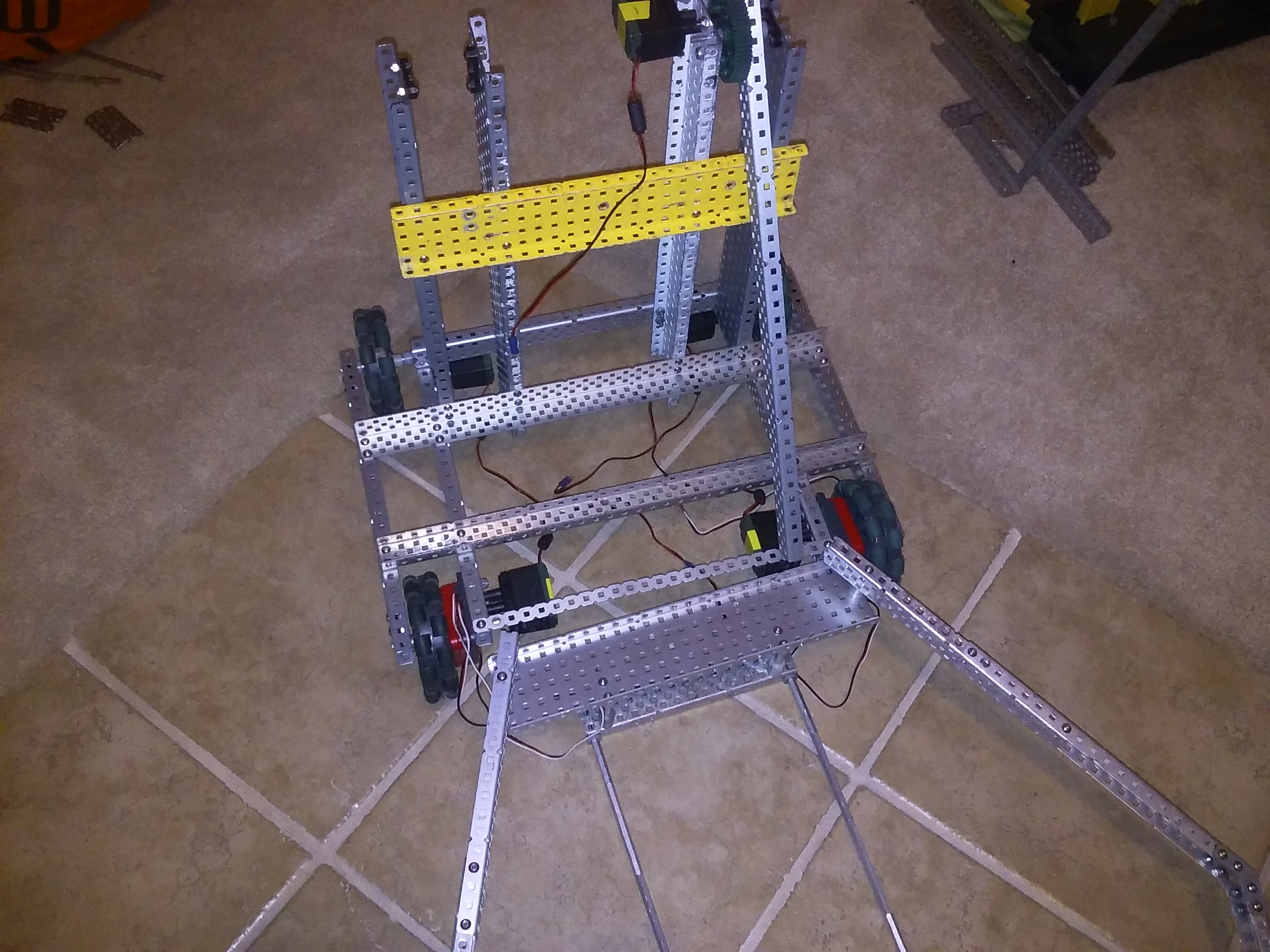

Okay, I have built a very minimal base and put up my C-channels for the tower… Granted those C-channels (on the tower only) are steel but it’s already 8.4 pounds and I haven’t even added the whole arm, most of the motors, the pneumatics, the cortex, and the batteries. I’m struggling to understand how your robot can be that light.
I guess steel is just really heavy? Too bad that’s all I have to work with there…
Picture of what I weighed for those interested:
You just gotta use aluminum and not that much of it. And no bearing flats. And nylon screws
The main thing here is the steel C-channels. I’ve kept everything as minimal as I felt I could while still keeping it structurally sound.
And I didn’t use bearing flats where I had motors to hold up its side on the base.
Just dont use toss up 127C metal and youre set
But what if that’s the source of my power?
